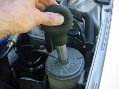

Dude, seriously, try and flush it out yourself, you can't make it any worse, just don't run it without any fluid.
Drain it, add fresh fluid, run it with the A/C on high, repeat it a couple of times. You can do this yourself.
You might very well be able to clear up the fluid and possibly save the pump, you don't know until you try.

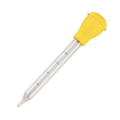

Maybe even get one of those suction guns or your wife's turkey baster and get that Pepto Bismol out of there.
add Mercon ATF, repeat until clear. If it doesn't clear up, at least you tried ....

wow BigRigLS, The first picture right there looks exactly like mine. The fluid is almost white and frothy.
How is the proper procedure to flush and refill the fluid? Also where can I get that vacuum or pump to extract the fluid?
Thank you so much for your help!!!
Oh man sorry you already explained! I didn't read it. Sure, I'm going to try it out. I will keep posting updates!
... where can I get that vacuum or pump to extract the fluid?
Try the dollar stores, no need to spend big money on a baster.
~ however, be prepared the pump may be done!
I agree
try it yourself, a turkey baster works great. keep emptying the tank fill with fresh fluid run car, drain tank again, fresh fluid run and drain. Small money, maybe save you big bucks.

As we speak he's outside with the baster pulling out all of the fan fluid. All the help being provided is greatly appreciated! Thanks guys!

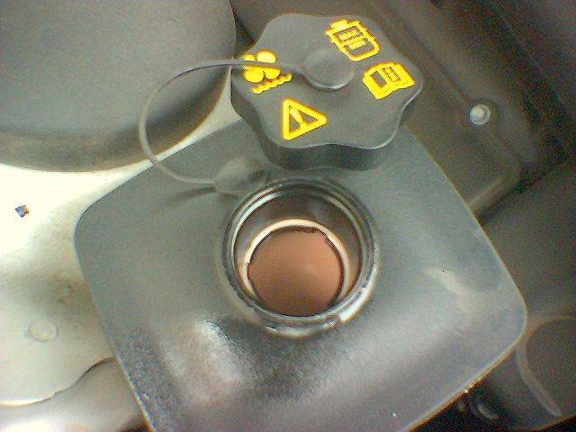

I haven't noticed any mention of the Degas bottle. When was it last replaced? I know you said the coolant level is steady but that doesn't mean there isn't a small air leak.
If it overheats at highway speeds, I would look into replacing cooling system parts too since the fan wouldn't be pulling any more air at those speeds than whats already being forced in.
