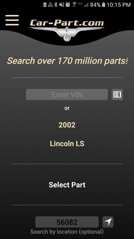

car-part.com just swap out a working sunroof assembly from a salvage yard
