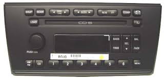

I have what appears to be a common problem with the CD player in my 2002 Lincoln LS.
Ever since I bought the car used back in January 2014 the CD player has not worked.
When I push the load or eject or any CD related button.. I get the message "CD error".
Not sure if a CD is jammed in there as I can't open the CD door.
Tried some of the tricks suggested on different threads like disconnecting the battery, pulling the radio/Cd player fuses, etc. but still get "CD error".
My radio is exactly like the photo I've included.
Any ideas other than getting it repaired (not worth the money IMO) or getting an aftermarket radio?

I bought a used 2002 Ls also and same problem. It had 7 disc in it LOL. I removed it With the AC panel as an assy "only way" then brought it in the house and took it apart as nec. not that big a deal. BTW you don't have to remove the Console like I have seen people say is nec. hope that helps ya.

I have an idea ? You can remove the Radio yourself and take it apart yourself and see if there are CD's stuck in it, if so remove them. That worked for me
I have an idea ? You can remove the Radio yourself and take it apart yourself and see if there are CD's stuck in it, if so remove them. That worked for me so far.

Thanks everyone for the feedback. Much appreciated. I'm not against getting an aftermarker radio. I was just referencing the fact that paying someone to repair a stock lincoln radio/cd player that is 12 years old
will probably cost as much (if not more) than a brand new aftermarket radio that is actually a better unit (aux in, USB, radio, CD, remote control, etc) so might as well go with the new unit. That being said I'd prefer not to spend ANY money (smile) and fix the current CD problem if possible. I'll consider the "take the unit apart" option.

I had the same issue with the stuck CD elevator. I disassembled mine while my OEM replacement was in transit. I learned quite a bit about how they operate. Unfortunately the one I ordered ended up having a jaammed elevator as well. So I contacted the seller and they sent me another free of charge. So now I have two disassembled OEM units, and a good operating one currently in the LS.
Personally I'd recommend ordering an OEM replacement. It'd be the most economical and easiest choice. If you go aftermarket you'll have to invest in a good faceplate/frame that will look nice and clean. Not to mention an adapter to keep your steering wheel controls. Either way the choice is yours.
I've come to find that the electrical connectors are very brittle and flimsy in the OEM stereo headunits. Both of my players (the original, and the defective replacement) were disfunctional due to electrical connections being broken on the inside. The orange thin tape that contains electrical circuit wires.
I've heard of these players failing electrically and mechanically in several different ways, some fixable and some not. But like I said, I'd just purchase an OEM replacement. Then you still have a clean factory look, and you have an old headunit for replacement parts if and when needed.
You should be able to find a blemish free, clean OEM unit for around $65-$100. Best of luck.
