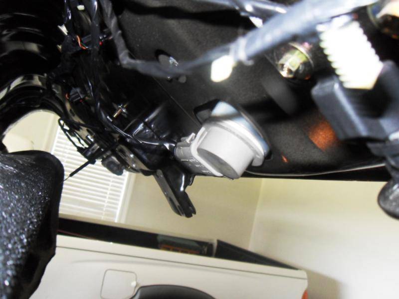

This is super easy. I got my trunk liner down right now as we speak because I was checking the condition of my tail lights. As you can see in the picture once you get the liner down they are right there in your face.

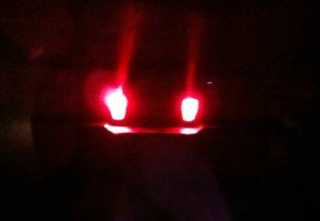

I just put in some Sylvania ERD halogen bulbs. They're for an overhead projector. They fit in the gen II reverse light socket (921 bulb). I read about them on a Dodge Magnum forum I think.
921 is 1.4 amp, ERD is 2.5 amp. They aren't crazy bright but certainly a step up I think :cool:
Supposedly the ERF bulb also fits, but that is 3.6 amp which seemed too risky.
I tried to take a picture with my phone after installing only the left side but it didn't come out so great.
Oh and my lights are tinted red in case you were confused by the color ;)
