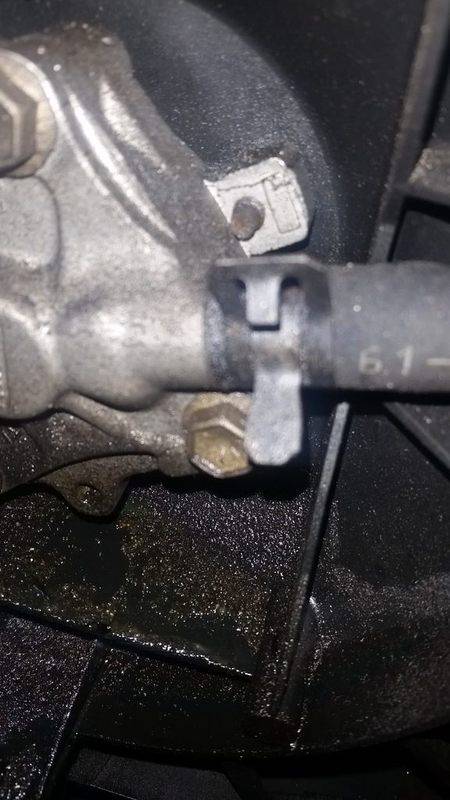

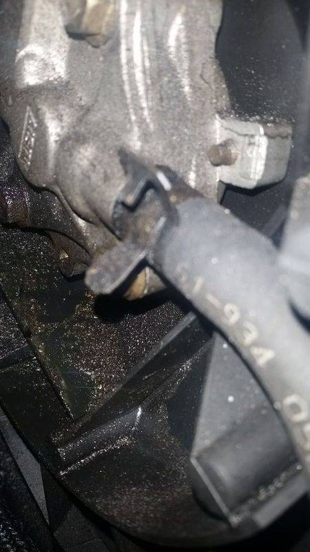

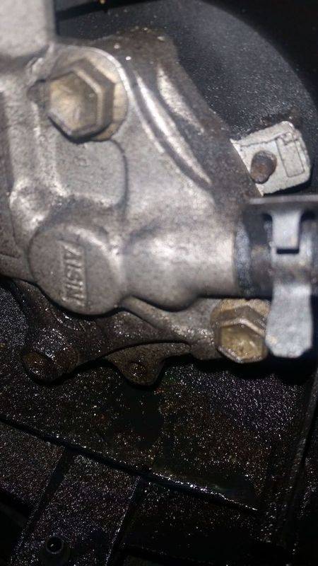

Well,like most water pumps,you see if the shaft bearing has radial play(wobble) and if the seal has been leaking out the weep hole in the casting. Mine had a slight wobble to it so I replaced it. Doesn't mean it won't pump okay with SOME wobble,but best not have hardly any.

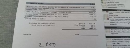

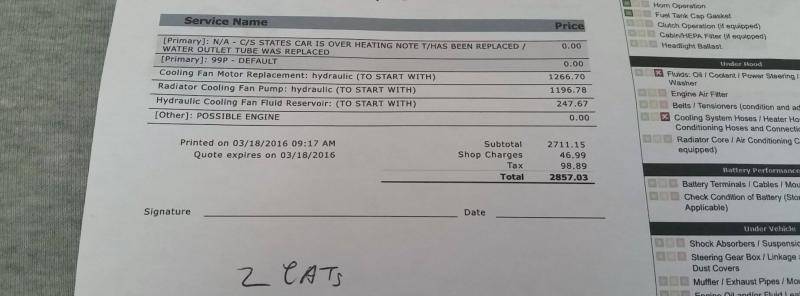

That flush and fill will cost you plenty. I'd try it myself again,UNLESS you're sure you got a true bleed by the book when you did it and you had strong enough antifreeze in there.
Anyway, no one can say you didn't try to fix it yourself. I hope you get it solved soon. don-ohio
