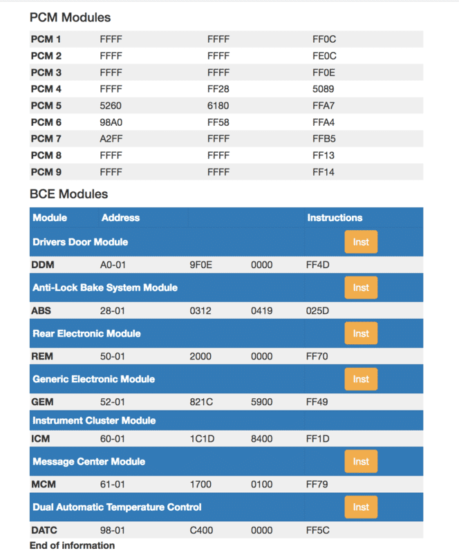

            I think I have a bad FEM just like in this post Stiff Steering; VAPS Codes My situation is almost the exact same. But I have a question since you said The FEM is sometimes inaccurately referred to as the GEM. I looked up the AS Built Data and I don't see any As built info for the FEM
            So what info do I program for the FEM if that is not the same as the GEM? If they are not the same where is the GEM located cause I can't connect to that module it fails to read.

            Quick Update:
            I replaced the FEM, then I was able to access the GEM and program it's As Built Data. So the FEM is seen as the GEM I am pretty sure cause once I changed that data and reset the codes that fault went away and I was able to test the GEM and it worked after that. So now the C codes are all gone and the Steering Wheel is smooth again :)
