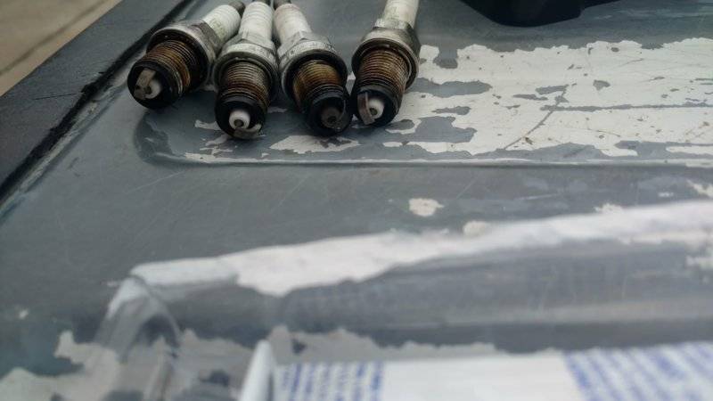

Here is what 1-4 looked like with less than 1,000 miles on the plugs.
5-8 had oil on them which I had expected cause the valve cover gaskets had went bad before and had already been changed out. We cleaned the holes up the best we could so I don't think that will be an issue the next time around. Since I am getting the issues with bank 1 side of the motor I am gonna just pay a shop tomorrow to change out injectors 1-4 and see if that helps. They were gonna charge $150 to change all 8 in labor. But Should be close to half just doing the one side.

From what I can see from the pic you posted only one spark plug looks absolutely terrible ...they look like they have some oil on them ...did you replace the valve cover gaskets already? I thought I heard you say you did but not sure? My plugs look so much worse not saying your issues are any less severe but your car isn’t running nearly as rich as my car by the look of the spark plugs

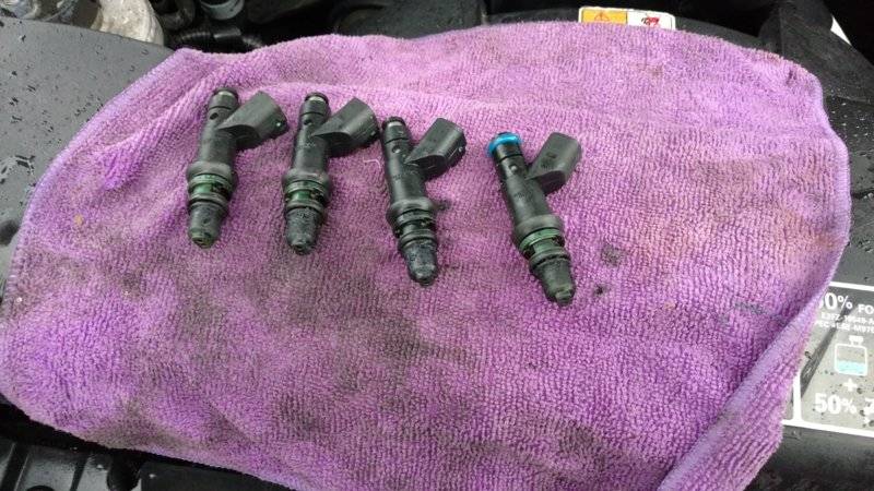

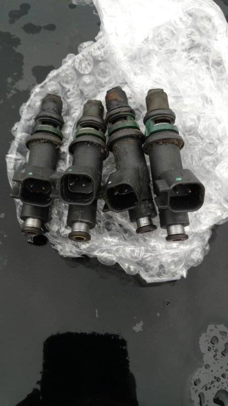

Got the old injectors out and got everything back in. There was one leak so about to sort that and then test out the car. Here is some pics of the old injectors

Me too bro ! They were actually a bit more dirty than that didn't get pics before they got handled and wiped a little bit. The guy that is helping me ran to the store to grab a wrench to get the EGR off so we do not have to take other crap back off from the passengers side. Will be a great time to clean out the EGR as well.

Did you say that one of the four fuel injectors was fouled? The picture you took of the plugs yesterday ...the one plug that stood out from the rest ...the one that was blacker than all the others...What cylinder was that plug out of?
Not sure if the injector was fouled, but the worse looking plug and worse looking injector were on the same cylinder which was number 3.
It is fixed ! Cranking up nice and strong now and a short crank never sounded so good to hear. So in the end it was the fuel injectors!
