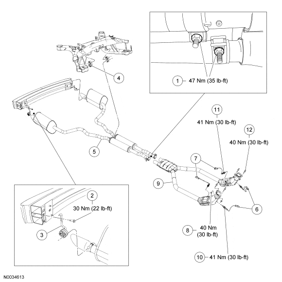

    Are the Catalytic Converters welded into the pipe on the LS ? I was wanting to take the pipes down and check the cats out since I am getting the p0420 code.

    This shows where things come apart. The two converters and the crossover are all one piece.

      Thanks I will start by swapping the sensors around then. I figured there was a not real way of seeing inside expect by cutting or using a camera inside the o2 sensor hole. If that does not move the code around to the other side then I will try a treatment of Cataclean. My tank is full of gas right now so I might try some Seafoam in it as well. And when the car get's down to a 1/4 of tank try the Cataclean if the problems still exist. Does that sound like a reasonable approach ?
