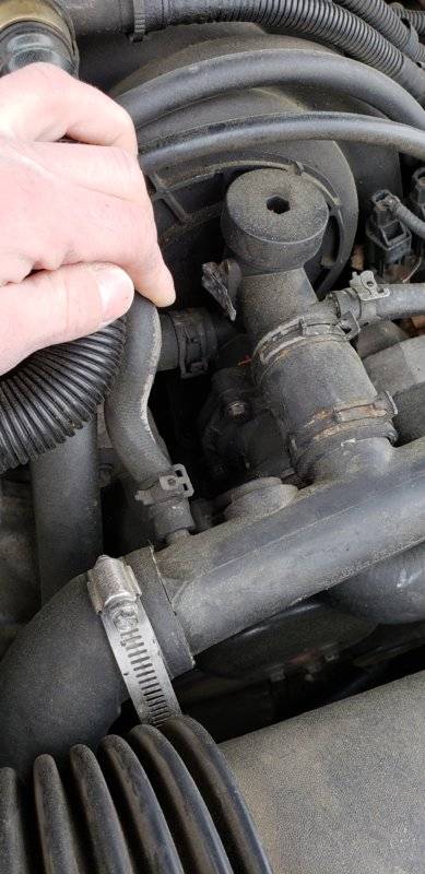

The reason I ask is I was looking at a v6 and the coolant fill valve and other plastic pieces look the same. Are those interchangeable?

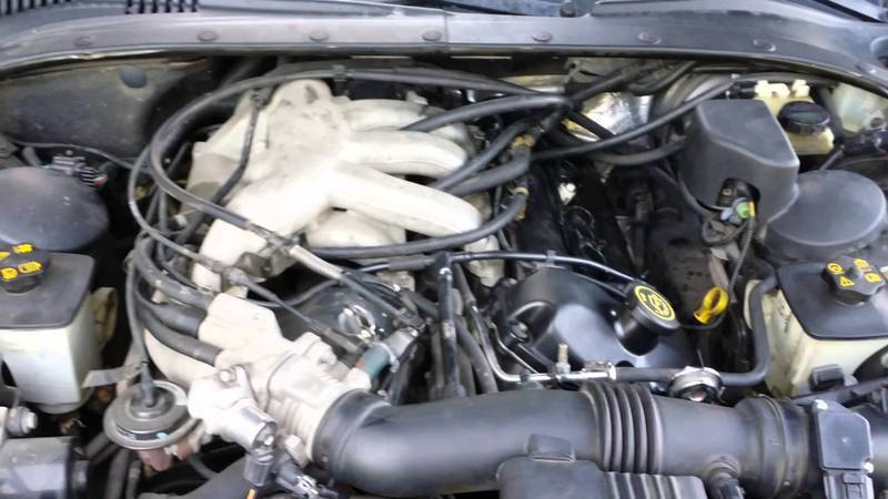

The first pic is my v8 and the second pic is a v6. Are the two plastic pieces I have circled in red interchangeable?
You have two pictures V8s there. The V6 and V8 cooling system do not share any parts, and are not similar at all.
Oh ok. I took the pic from a junkyard and I just went solely based on what they had on the windshield. They had it labeled a v6. Well thanks.
Oops, forgot. The degas bottle is the same for the V6 as the V8, but I'm sure that's the only cooling system part that is.
Yeah looks like it's ready ....good and cooked from the inside...mine turned brown also ...I would suggest running as fast and far away from that Pick and Pull V8 in the second pic ...go with the 2001 Euro Jag S-type aluminum T-Stat housing ...make sure to use MotorCraft Thermostat in it if you decide to replace ...you never know when that plastic crap will become dysfunctional and after changing this T-Stat housing you'll never want to do it again ...all my best
