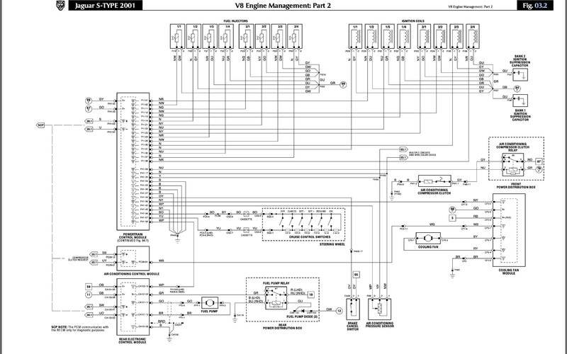

potato quality on here. a failing ignition\radio capacitor can short to ground and take out the entire bank. XR815096 is the part number
Wow I didn't know this good catch. so theres one for each bank, where is this"capacitor" located? does ford sell this? cant seem to find one for 2000v8 could I have a source Link please. thanks!
ajv8
Mar 5, 2021
192
120
Parts Unknown
at the back, above the fuel rail on both banks. will have a grey connector

Is there any way to test those capacitors?
Yes.
Unplug them. Test between the terminal on the capacitor and ground with an ohm meter. You should get a very high to off-scale reading if they are not shorted. You will get a very low reading if shorted.
I would expect and actual short to take both banks out and blow the COP fuse. An open capacitor might cause enough noise to crash the PCM or cause a whole bunch of false electrical codes.

Crap Jaguarparts.com wont ship to Canada
call a dealer up and see if they can get it. otherwise you can buy it direct from jaguar but they will have to ship from the uk.
XL1Z-18801-AA looks pretty similar and uses the same connector but it’s missing a wire.
i would test it with an ohm meter first. swap between banks as well

@ajv8 @joegr thank you a ton for info and help but I cant seem to find the problem, no vac leaks... I unplugged working side transformer capacitor still runs and the passenger one broke but runs the same... computer says p0307 #7cyl misfire howerver i put another 4 other coils on the mising bank and same thing I even took the fuel rail off and injectors sprays ok they all work no leaks at orings , but less pressure on one side of the exhaust makes me wonder.. will check exhaust tommorow and if its not that idk but might be the pcm?
