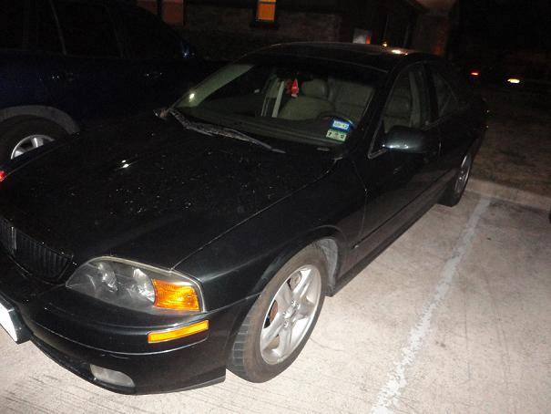

pic

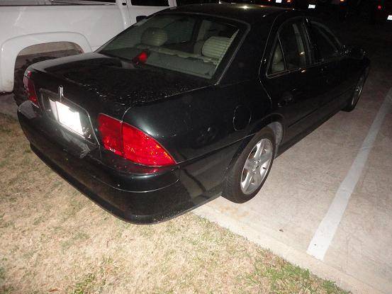

here is the back end
i love the color too, the heater is not working ill be looking into it sometime this week
need to have the glass tinted asap
