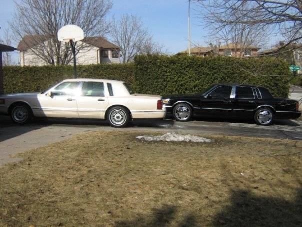

Can you post a picture of your car from the front looking down the side of the vehicle like you did on my post about "EATC ERROR CODES" in a larger format? I may be able to help you with one of your issues with your wheels. I have had 20 inch wheels for 3 years and never had any issue with shuddering.
