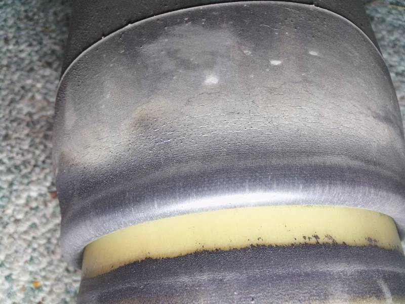

Below is a pic of a leaking bag. This was mine back in 2012. Over the years of going up and down, the rubber started attaching itself to the bottom. This resulted in the bladder being thinner. Then the cracks started leaking when right at that fold. Only one leaked but the whole front would drop when my garage reached the mid 40's. Only one alone can't hold the weight. Hopefully you'll find what's wrong pretty soon.
