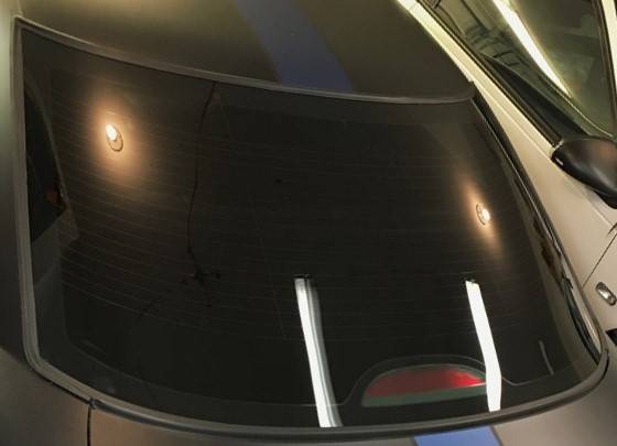

The seal is integral with the rear glass and does not actually "seal" the glass but is more of a beauty trim surrounding the glass. The glass may be mounted with typical windshield ribbon sealer but without the trim depending on the care taken to properly gap it evenly all around and have it flush with the surrounding body panels.
I cheated and used a full sheet of vinyl wrap.
