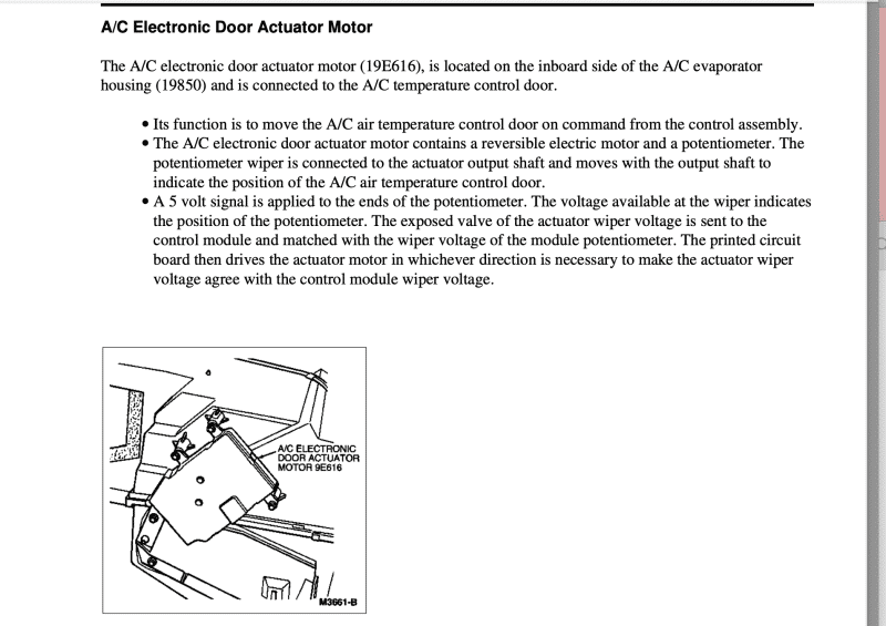

Lastly B6 says the actuator connector is accessible but I’m having trouble finding it, does anyone have pictures or been able to reach it before?
I assume "accessible through the glove compartment" requires removing the glove compartment. The actuator should be to the left of the blower motor, probably accessible to the left of the glove box opening. This is the best I can do... a screenshot from the manual:

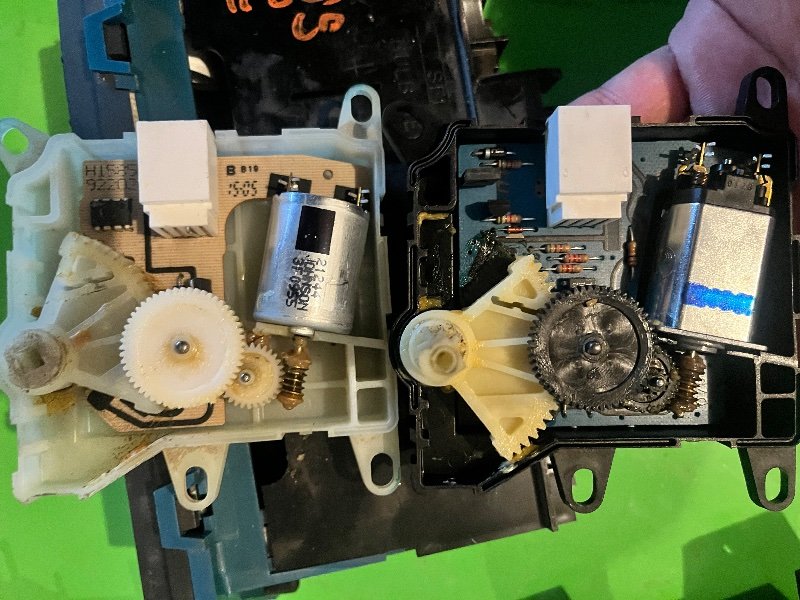

Thanks for the help, I ended up pulling the dash back to test the connector and it seemed to work out, Now the actuator is pulled and found the gear is stripped (the one against the motor). I know they no longer make the part and have read the gear also comes in the newer models so I have one of them ordered to give it a shot. Is there any other tips or tricks I should do to the actuator or anything else behind the dash while it's loose?

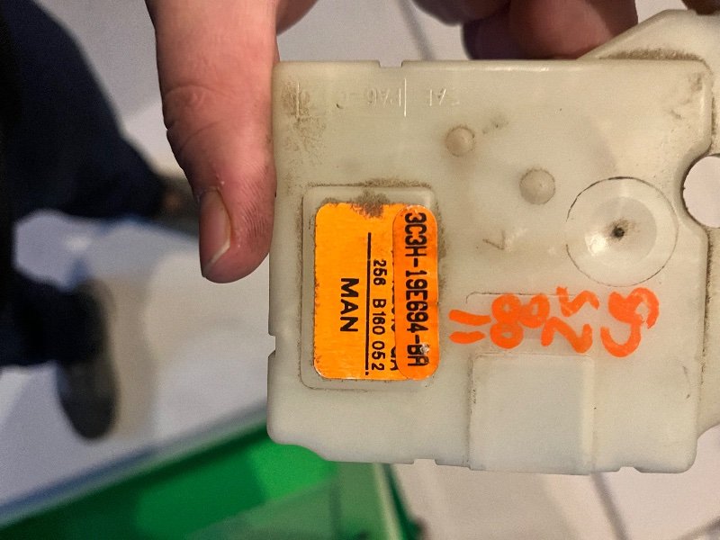

New progress. for anyone going to try swapping for the updated gears, don’t buy anything doorman made as they updated the design with less gears, I was unable to find a 97+ mark 8 near me so was unable to try it.
Out of curiosity I found the original actuator off an older model superduty has all the same gears as our 96 Lincoln’s, as well as being the updated black plastic. (Superdutys are also much easier to remove as there fully accessible from the glove box with no tools necessary).
I have added pictures of the superduty actuator I got, as well as the internals of both (this is with the gears already swapped)
Hopes this help’s someone!
