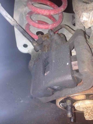

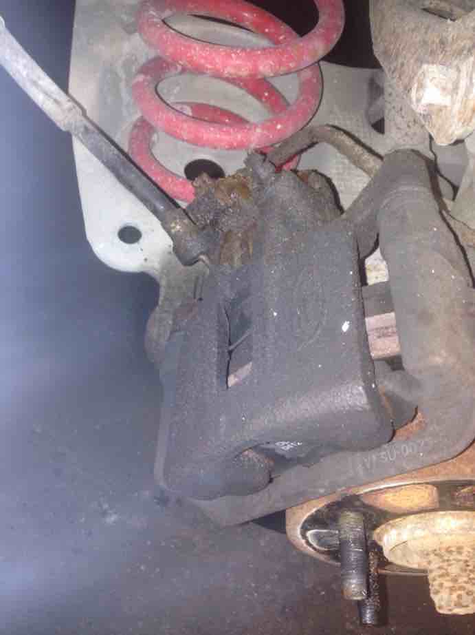

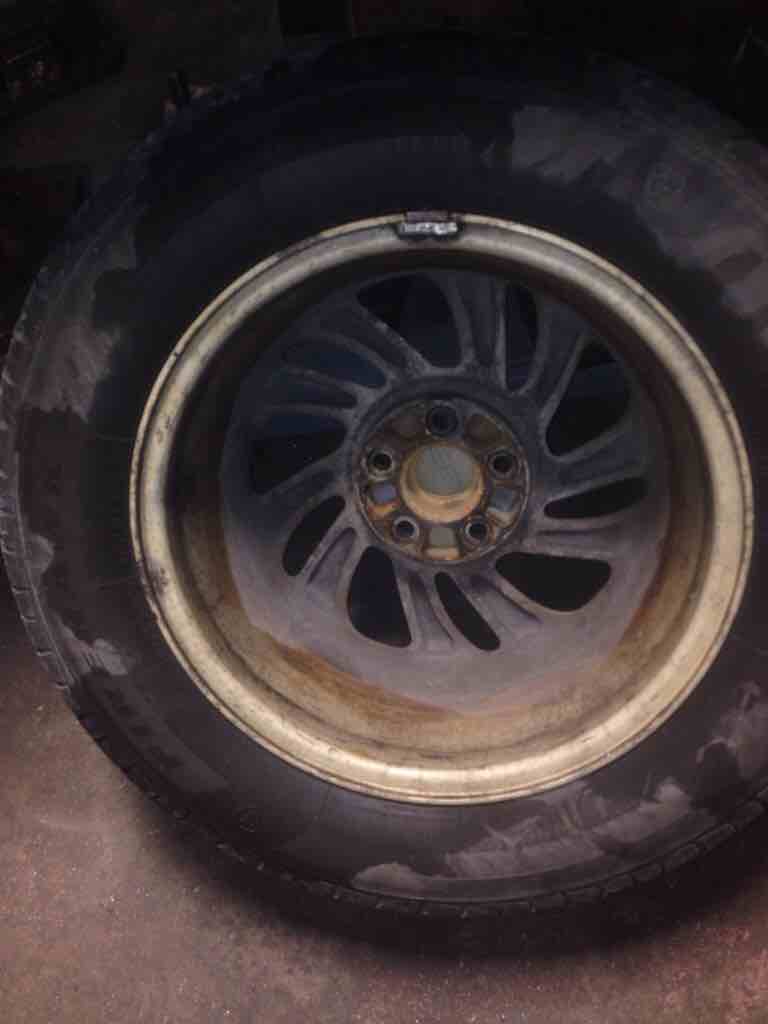

Ok. I jammed the crap out of the pedal to see where it could be leaking from. Upon inspection I believe the leak is from the right rear caliper where the brake line bolts on. The wheel was holding the fluid and then it flung off when driving. I've included pics of both the suspected leak spot and the tire. Does anyone agree?ImageUploadedByTapatalk1413657697.990062.jpgImageUploadedByTapatalk1413657714.123894.jpg

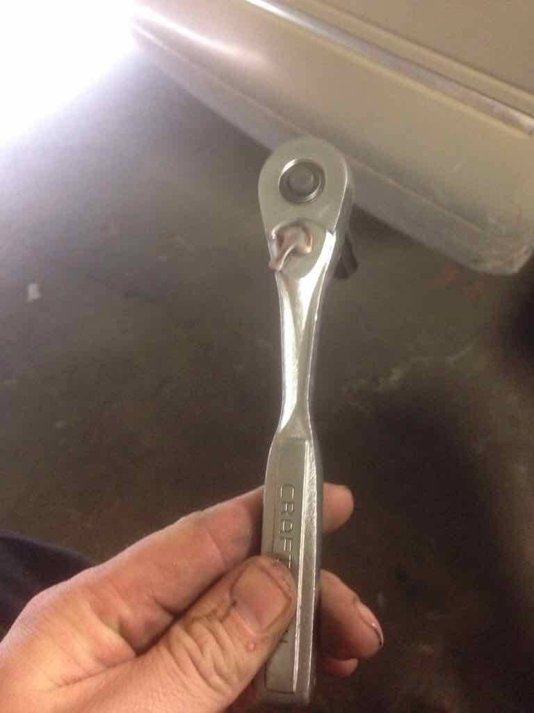

I also tried to tighten that bolt. It did turn about 1/8 turn with just a 3/8 ratchet that is not long. I've had that happen once before many years ago. ImageUploadedByTapatalk1413657886.156590.jpg not a big tool. Couldn't apply much leverage. But it did turn. Thank you everyone for your opinions. Even though I DD this car I want it to last since the mileage is relatively low for the $900 I paid for the car. And yes I see the sway bar link is missing on this side.
