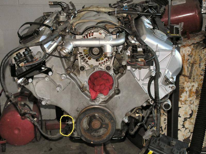

+2 unplug then plug in the crank position sensor. wont be fun in the dark, pass side next to the crank pulley

Not yet Sapp, I should be able to do it tonight. Do we check at the number one cylinder or does it really matter? Thanks Chicken, I took a look with a flashlight and saw the connector for the CPS, looks like I'll have to jack her up a bit to get to it.
dug up an old pic just to help

Unplugged the CPS and plugged it right back in. Bingo fires right up!
Only thing that really sucks is if you have to replace the CPS cause there is no room to easily pull it out of the timing cover :mad:
Try the unplug/clean connector/replug on the CPS before you decide to replace it..spray it with some brake parts cleaner.. If it needs to be replaced, you'll have to remove the AC compressor for the room needed

Thanks everybody for your help. I removed the electrical connector to the compressor at first thinking it was the CPS and cleaned the crap out of it with MAF cleaner then put some dielectric grease in the connector. Of course it was still just cranking so I looked closer and realized, I was an idiot. Looked closer towards the crankshaft pulley (thanks so much Chicken) and removed the correct connector and repeated above procedure. I put a lot of dielectric grease on the connector. Sure enough she started right up. I turned it off and tried about 3 more times and it kept starting right up.

chicken, what is that Alternator specifically for in your pic? i had one JUST like it that was bad and i warrantied it out and got a regular lookin Mark one back... i want my cool lookin one again
dunno, thats the alt that came on the junkyard motor out of a 95 mark, and is still in the bird today. the thing that confuses me is all the people lately saying a crown vic etc alt will fit cuz they shouldn't (stock for stock) we were gonna use his sohc alt when we did the swap (cuz it was fairly new) and the alt was too deep and touched the intake so maybe some of the after market ones are skinny i dunno
