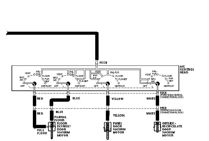

..Air is coming out the Defroster - Not from any other Vents - ...
Are you having temperature control issues? (Hot air when you want cold, or cold when you want hot?) If not, then the air temperature blend door actuator (motor) is not what you need.
Where the air comes out is controlled via vacuum powered actuators, and these are controlled by solenoids in the climate control. Air out the defrost is what you get when there is no vacuum. Check to see if the vacuum canister under the hood for the climate control is okay and if vacuum is getting to it. Then check to see if vacuum is getting to the climate control. I think that for a 94, it's most likely going to be a vacuum leak.

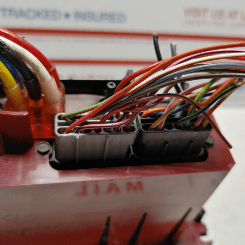

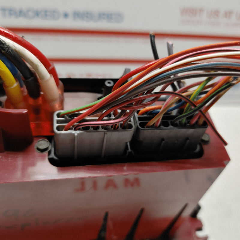

So, I looked up the Mark VIII climate control on ebay.
Is this the one you have?
This one does have the vacuum solenoids in it. You can see them in the upper left of this rear view picture.

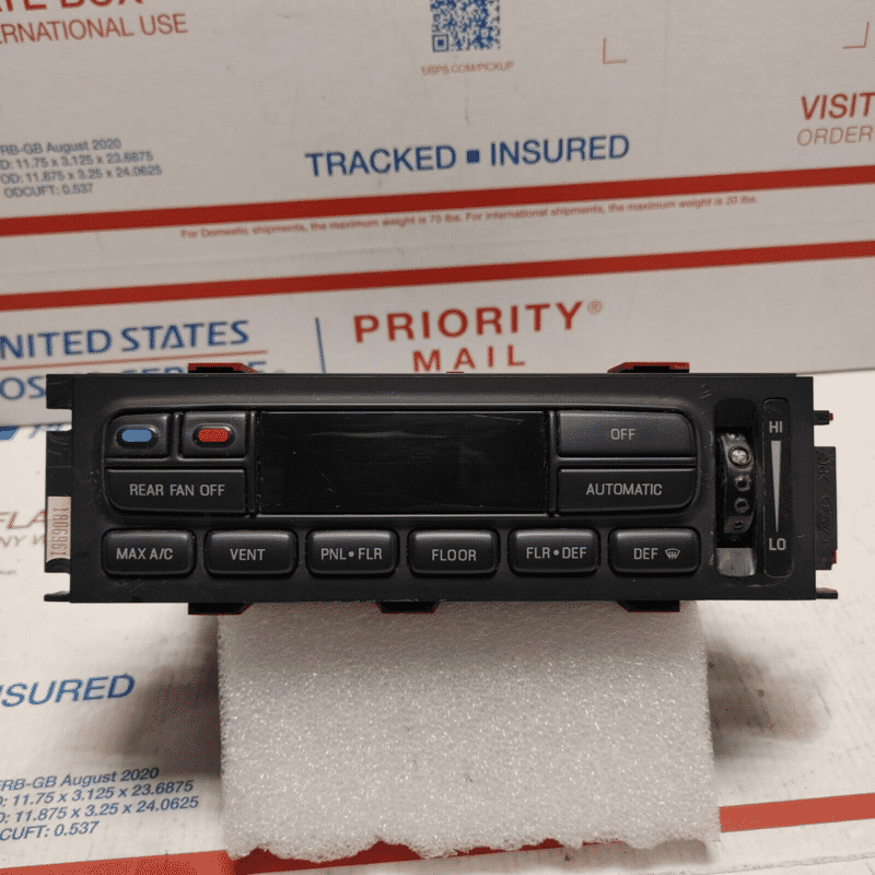

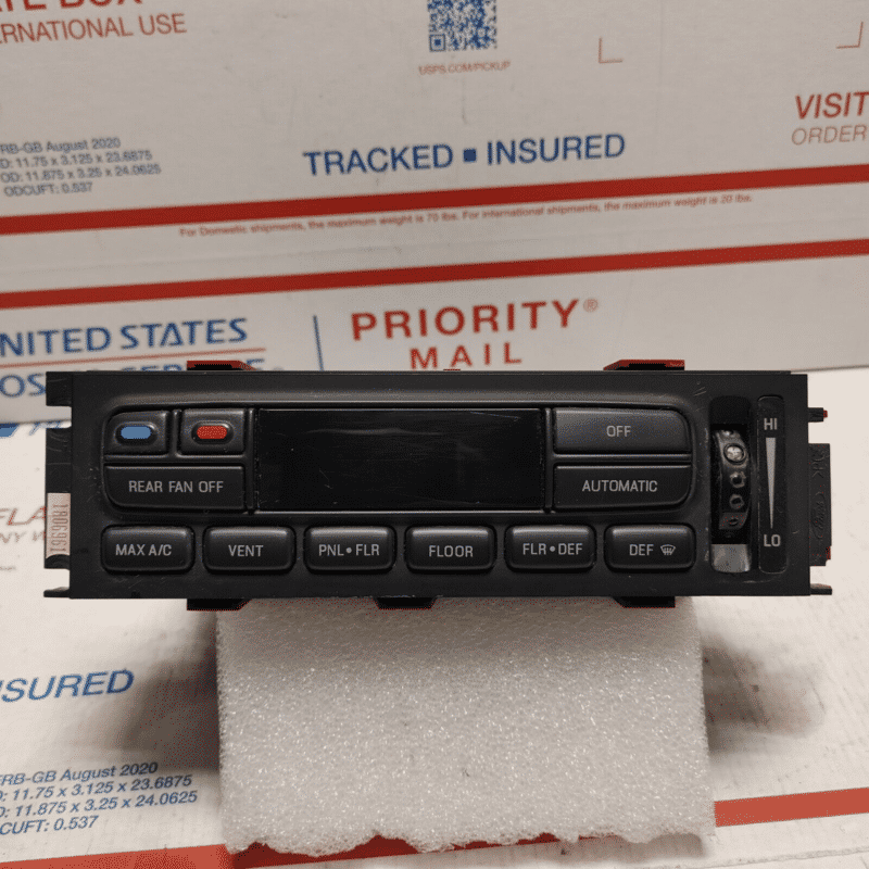

I think you may be thinking about the HTAC push button dash controller
Actually I just remembered I had that item (Heat/AC Dash Push Button Controller) replaced with a used one from Ebay some years ago (1995 with hard buttons) - This may be my problem (hopefully) easier fix. Anybody have the 1995 Temperature Controller OEM number - I will do the Self Diagnostics on it first - want to stay away from the plastic slide in tabs that always fall out or cave in on the 1993 and 1994 models - Have had the 1995 Temperature Controller in my 94 Mark for many years now and was working well. Need to check

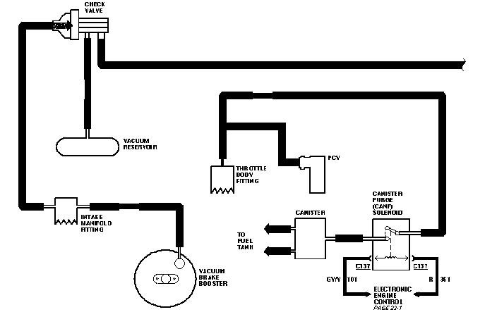

You'll find your problem from tracing the vacuum line from the intake manifold tee fitting. Most will break or separate right at the tee fitting.
