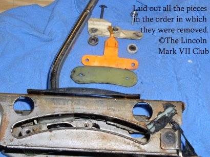

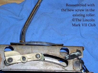

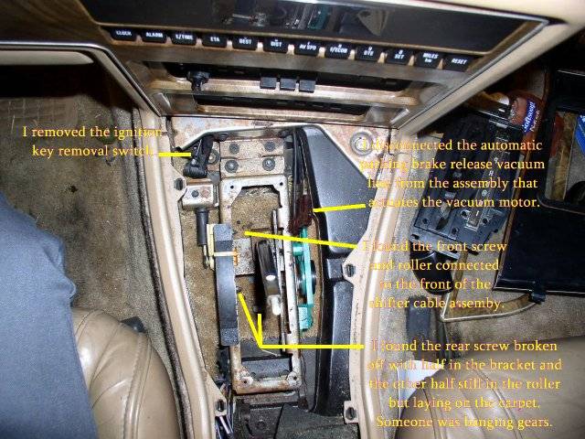

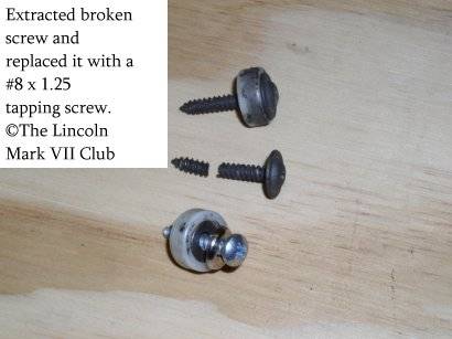

1984 Lincoln Mark VII Shaky Shifter.
The shifter on this car has been sort of floating since day one. After talking to Brian W about his 1984, I decided to open up my shifter and was truly surprised when a busted screw, a roller, and a steel clip fell out of the driver's side of the center/shifter console.
