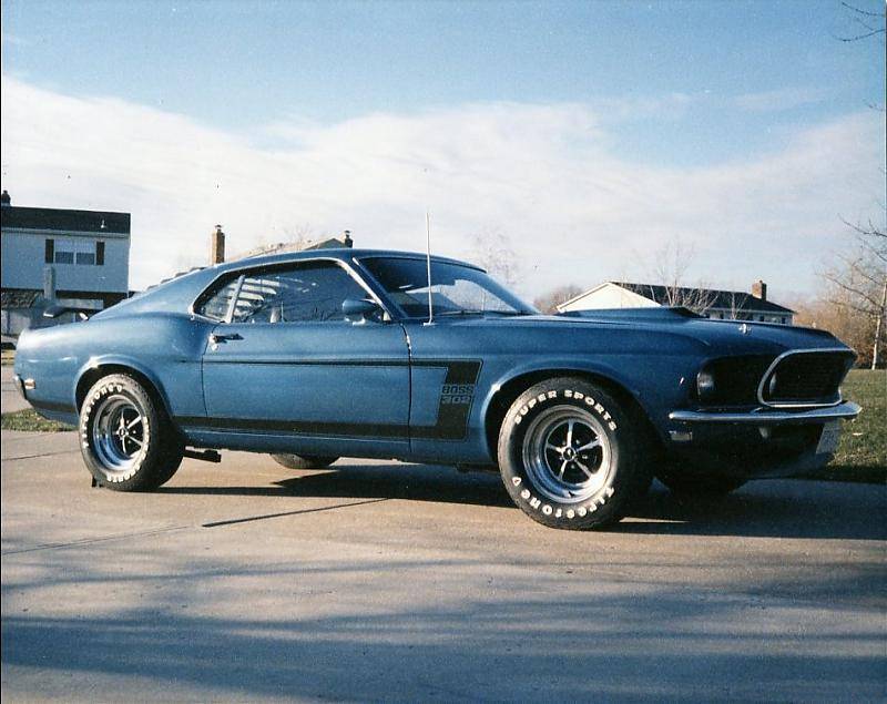

Here is a couple of old pictures of rides I put together. The Boss was a total restore. Your budget will guide you.
