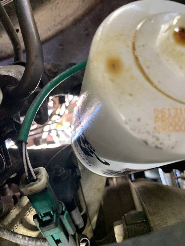

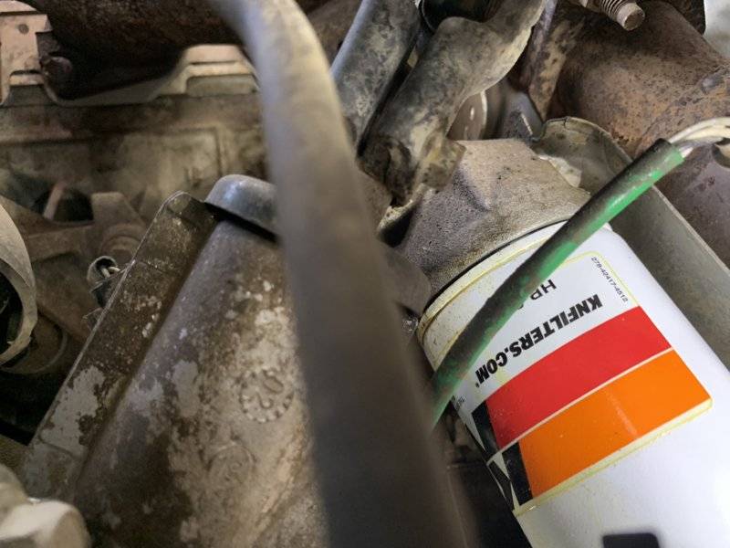

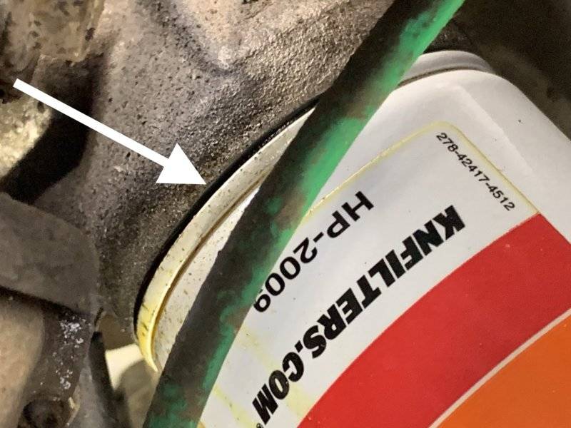

    Got underneath the car this afternoon and took a good look after driving around to warm up the engine for about 30min. The oil is leaking from the gap between the top of the oil filter and where in threads into the bottom of the car. I didn't see any other leaks.
    Thing is, it doesn't always leak. Last time it did it was after I'd driven for about 2 hours on the highway. I parked it and the next day noticed a small puddle right below the filter, which was dripping oil. Maybe 1/4 of a quart.

    Between the adapter and the oil filter is only the gasket on the oil filter. If the mating surface on the adapter is good (no scratches or other issues) then you might try a different brand of oil filter and maybe tighten it a little more (not too much). Otherwise, the leak could be from somewhere above where you think it is.

      I've tried a few different brands but I'll still occasionally get the leak. I did inspect the mating surface and it seemed smooth and free of any damage, cracks or gouges. I realize that the gasket on the filter is doing all the sealing at this juncture, which is why this confuses the hell outta me. It's a simple seal and I don't see why it's not sealing.
      I was hoping this was a common problem but it seems like it's not.
      I'm going to install a different brand, and while the filter is off do a real good inspection of the mating surface.
      I have another long drive ahead of me this weekend so we'll see what happens.

      Also - as you can see, there doesn't seem to be any signs of oil leaking from above in the photos. And when I inspected from above and underneath, I didn't see any oil where it shouldn't be. Strange.
