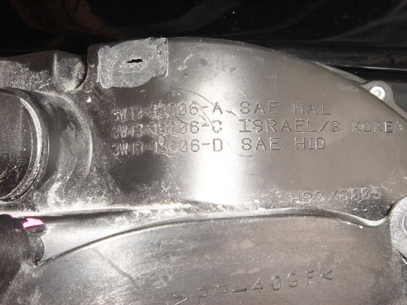

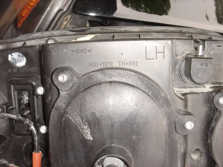

That is a very good question that I have never found the answer to. When doing my headlight retro, I ordered a pair of second generation headlight housings and upon close inspection, it has halogen and HID D2R on the back.. is it possible that they are the same housing with the same reflectors, but fitted with different bulb rings to correctly place the arc of light?

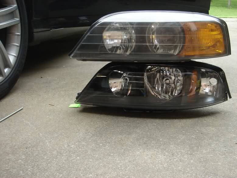

different reflectors!
Have you done a direct AB comparison? I have not, so I cannot definitively say that they are different. In most other vehicles, the optics are different between the halogen and HID counterpart...and the LS is probably the same, but again, I am not 100% certain.
This has been done before.
The OEM HIDs have different reflector bowls
Why does this keep coming up?
The reflectors are different. I have two LSes, one with halogen and one with hid. It is 100% clear that the two have different reflectors.

I dont know what they have but my hids have a cut off that the halogens didn't so something is different.
okay cool! i guess it is the housings that are the same but just different reflector bowls inside of the housing for halogen and HID. Thanks for clearing that up!
