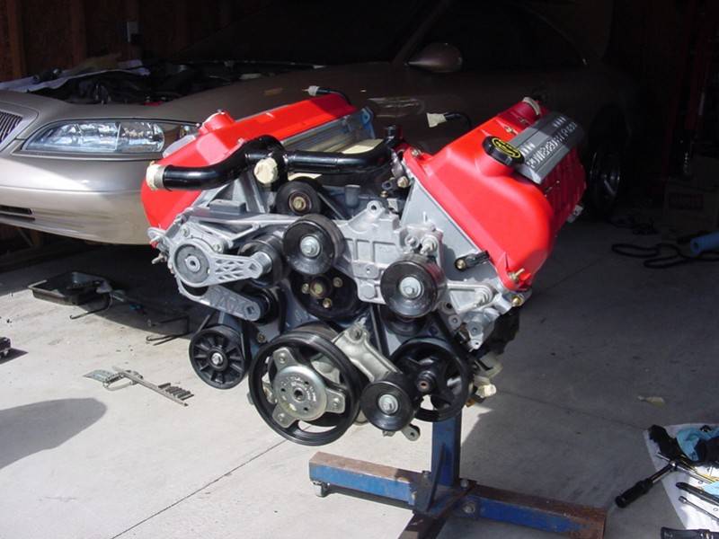

Yup, direct bolt on too. You will need a few supporting parts for it though. These are just the major parts:
03/04 lower plenum with intercooler
99+ "C" heads
03/04 timing cover
03/04 heat exchanger
hood
