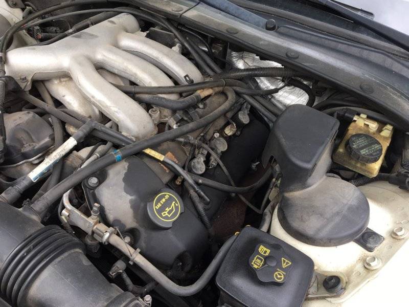

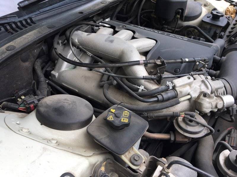

  6. LSGee
    LSGee Active LVC Member
    Messages:
    106
    Likes Received:
    5
    Joined:
    May 1, 2014
    Location:
    Falkville, AL

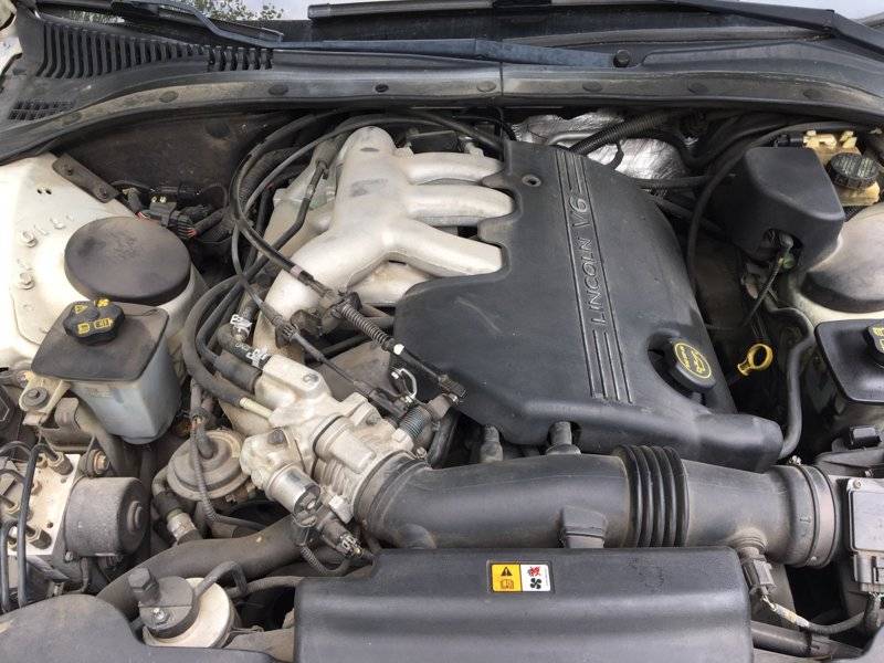

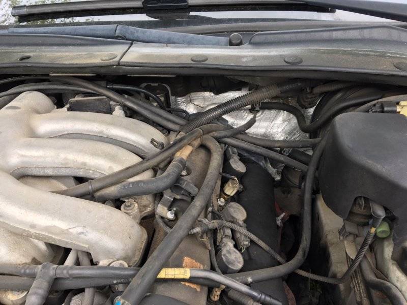

    I hope these help.

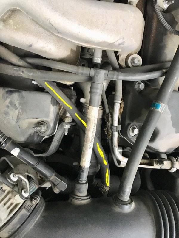

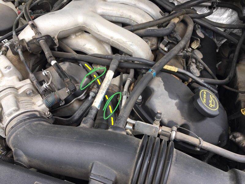

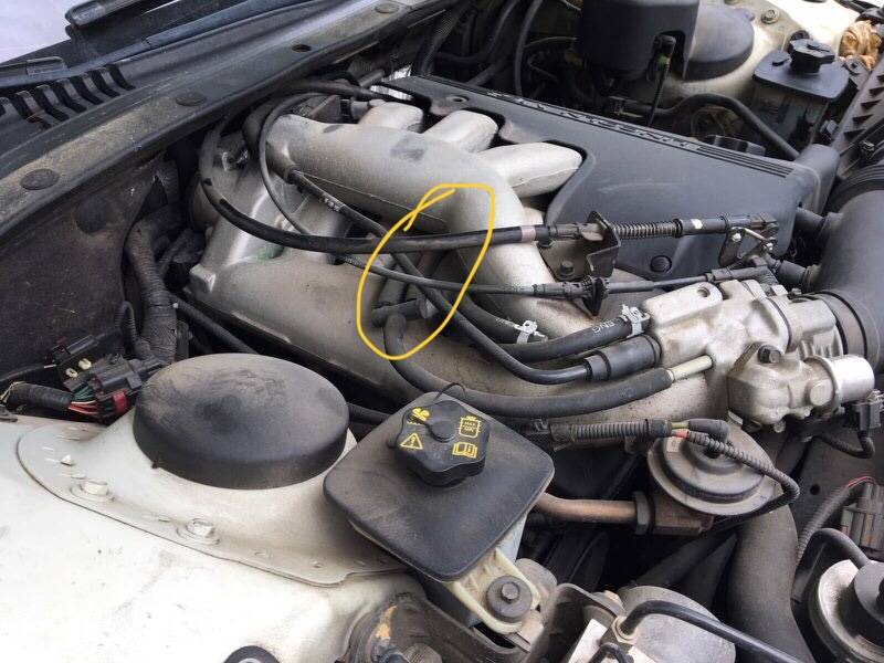

      Can you tell me what two hoses those are running to?
    • Allyson21
      Allyson21 New LVC Member
      Messages:
      7
      Likes Received:
      Joined:
      Sep 14, 2018
      Location:
      Alabama

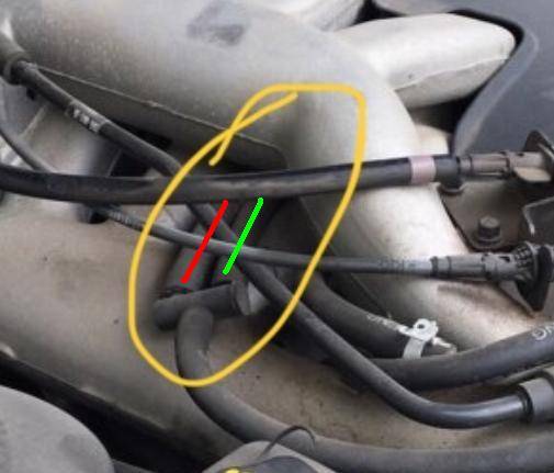

      If it is these two hoses, can you tell me where the smaller hose is running to? Does it go to the degas bottle? And if so, which one of two lines is that? The one closest to the firewall? Or the one in front of it?

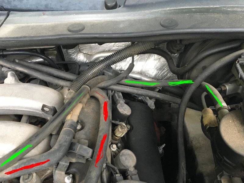

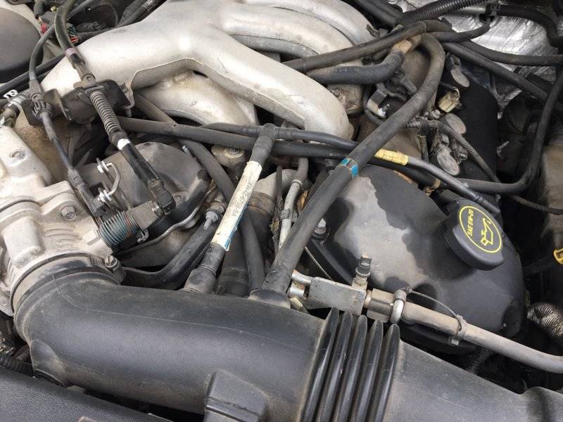

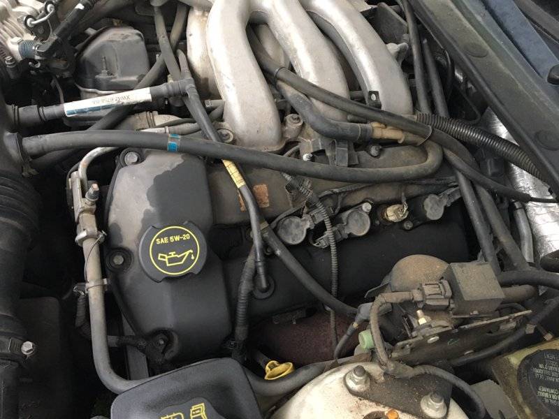

      And where is that one going?

      yes, those 2 hoses are the same.
      • Like Like x 1
          Messages:
          106
          Likes Received:
          5
          Joined:
          May 1, 2014
          Location:
          Falkville, AL

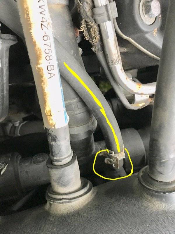

          if you're referring to this hose, it goes down to a plastic "T" that's under the intake tube. there's a small nipple on that "T", if you don't see it, it's probably broke because its real easy to do that......I know because i broke mine.
          • Like Like x 1
