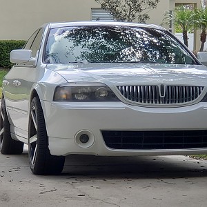

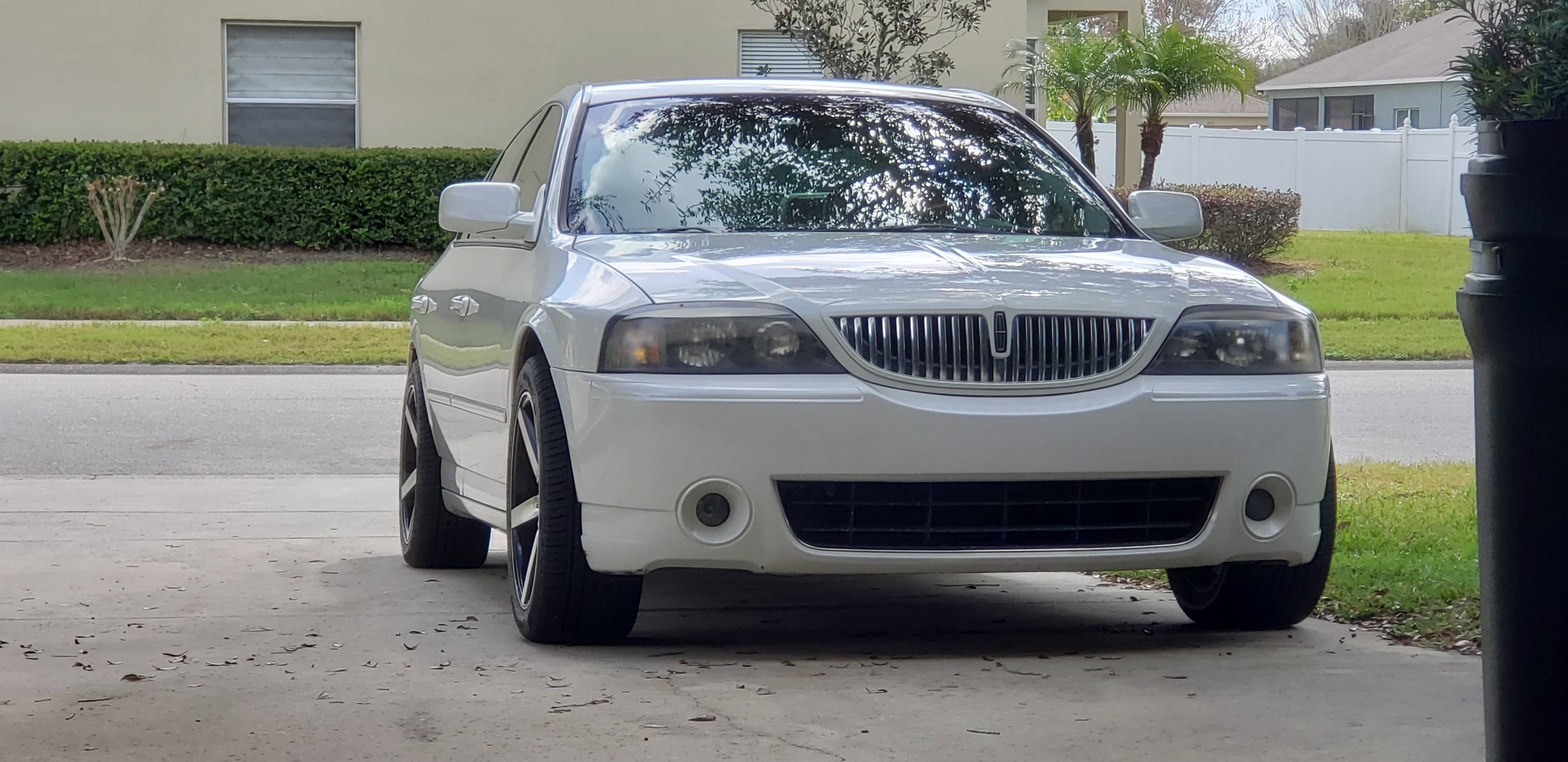

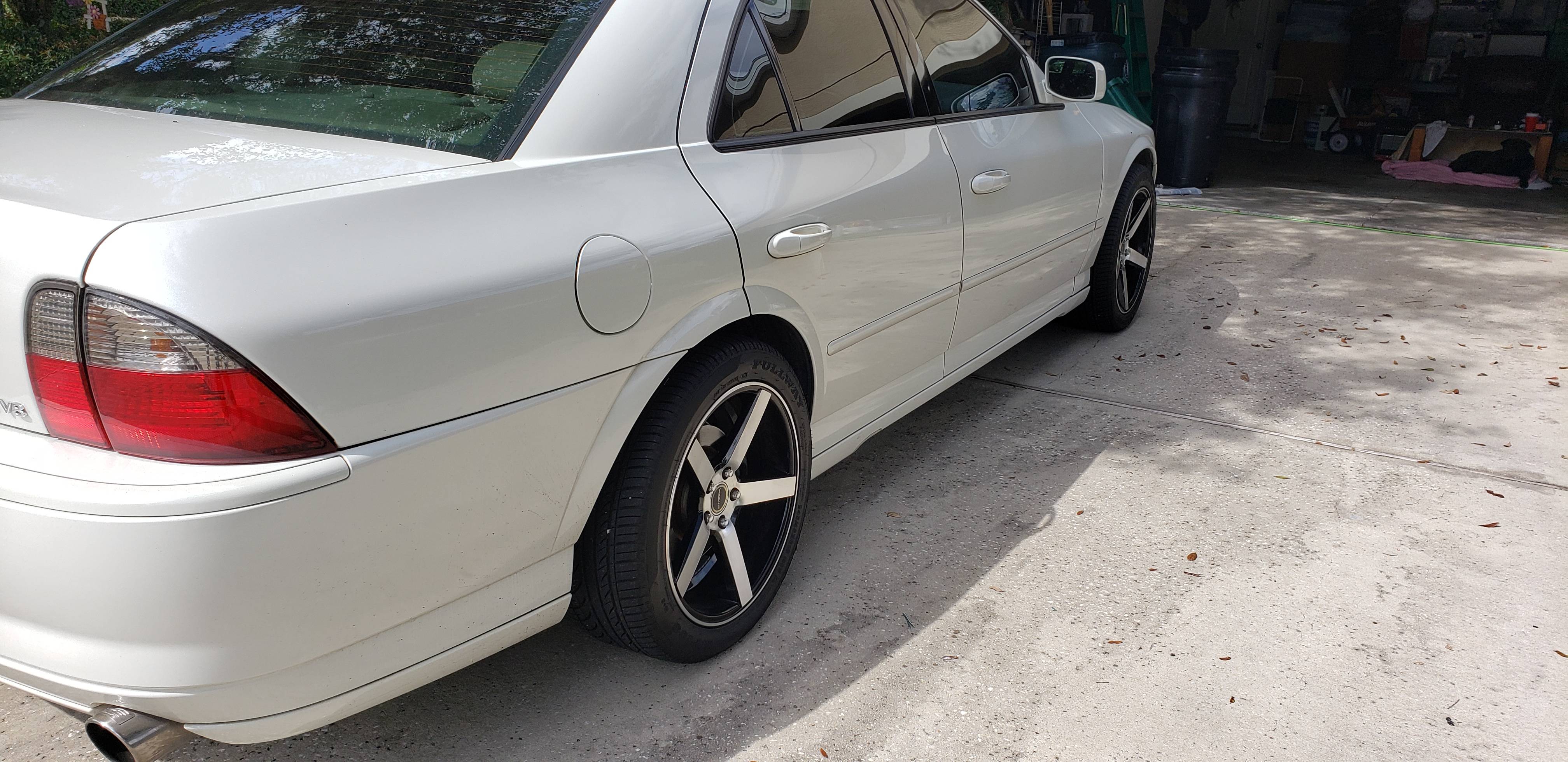

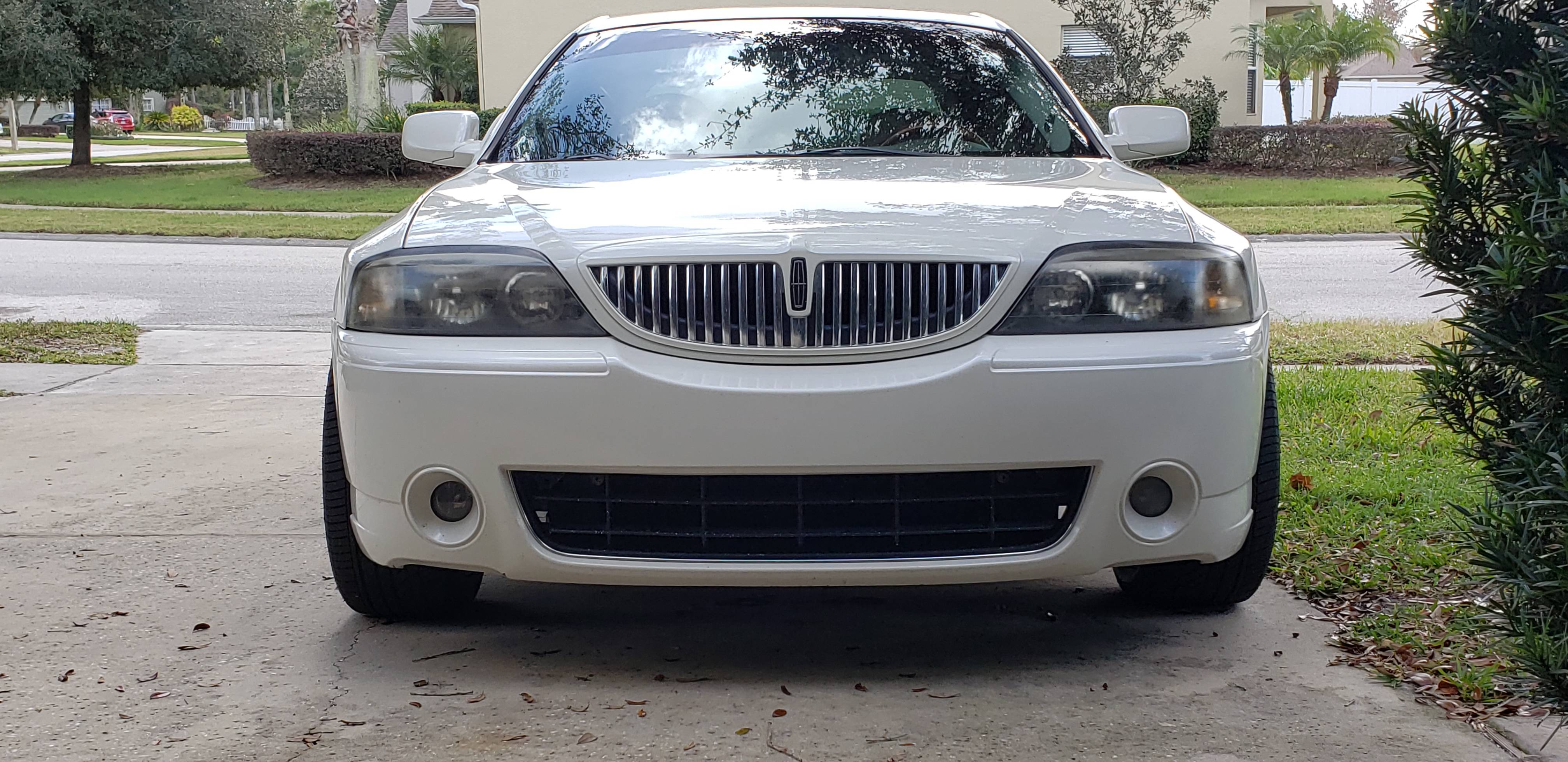

Love this car thru all the issues and getting them all worked out at the end of the day this car is just fun.

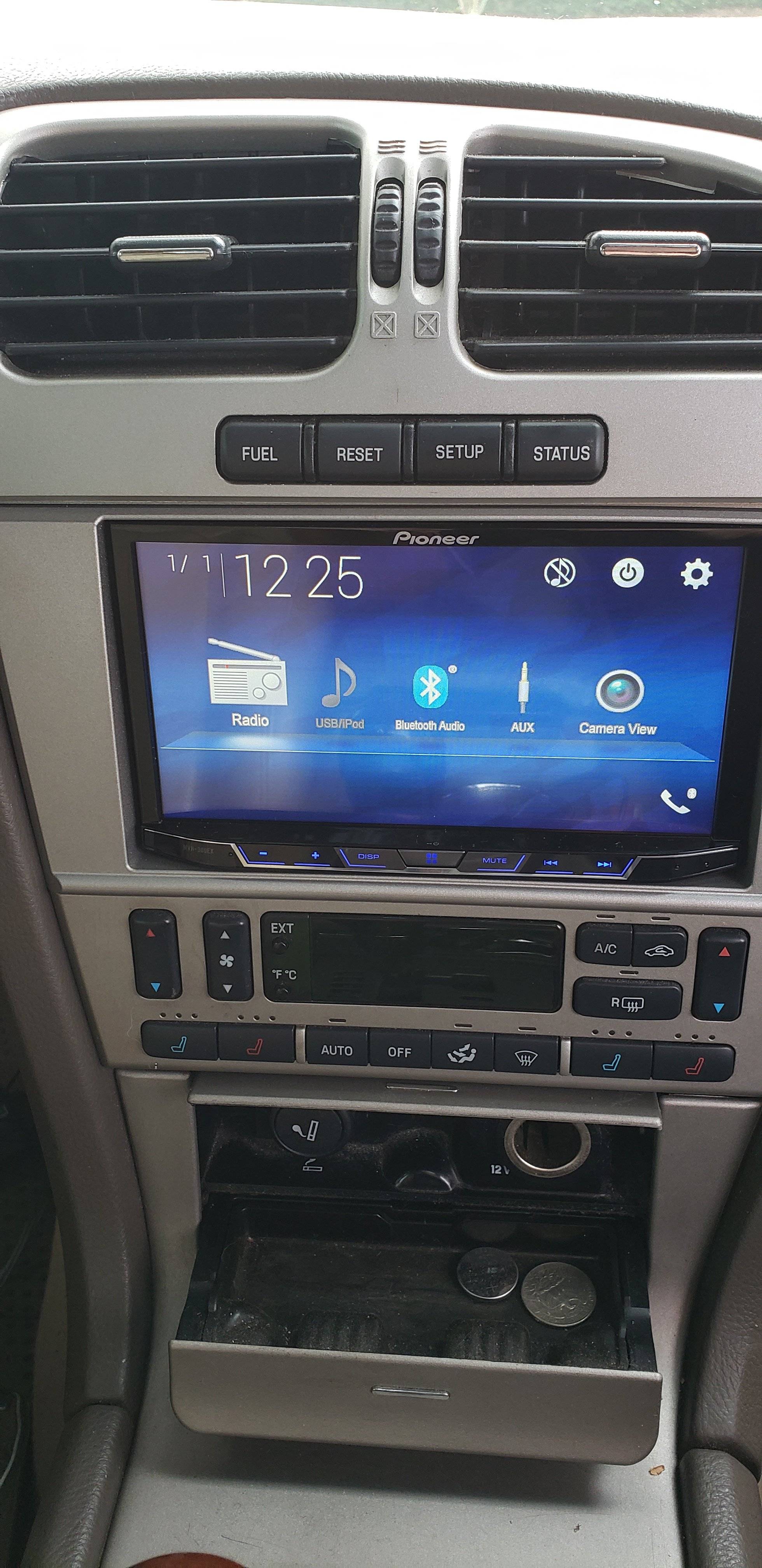

Mvh-300ex added a mini amp to rear deck subs added tweeters to a pillar and 1 12 inch sub to trunk in sealed enclosure for space sounds pretty good stock door speakers kicker 6x9 component to rear used tweeter from set for a pillar

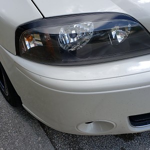

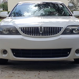

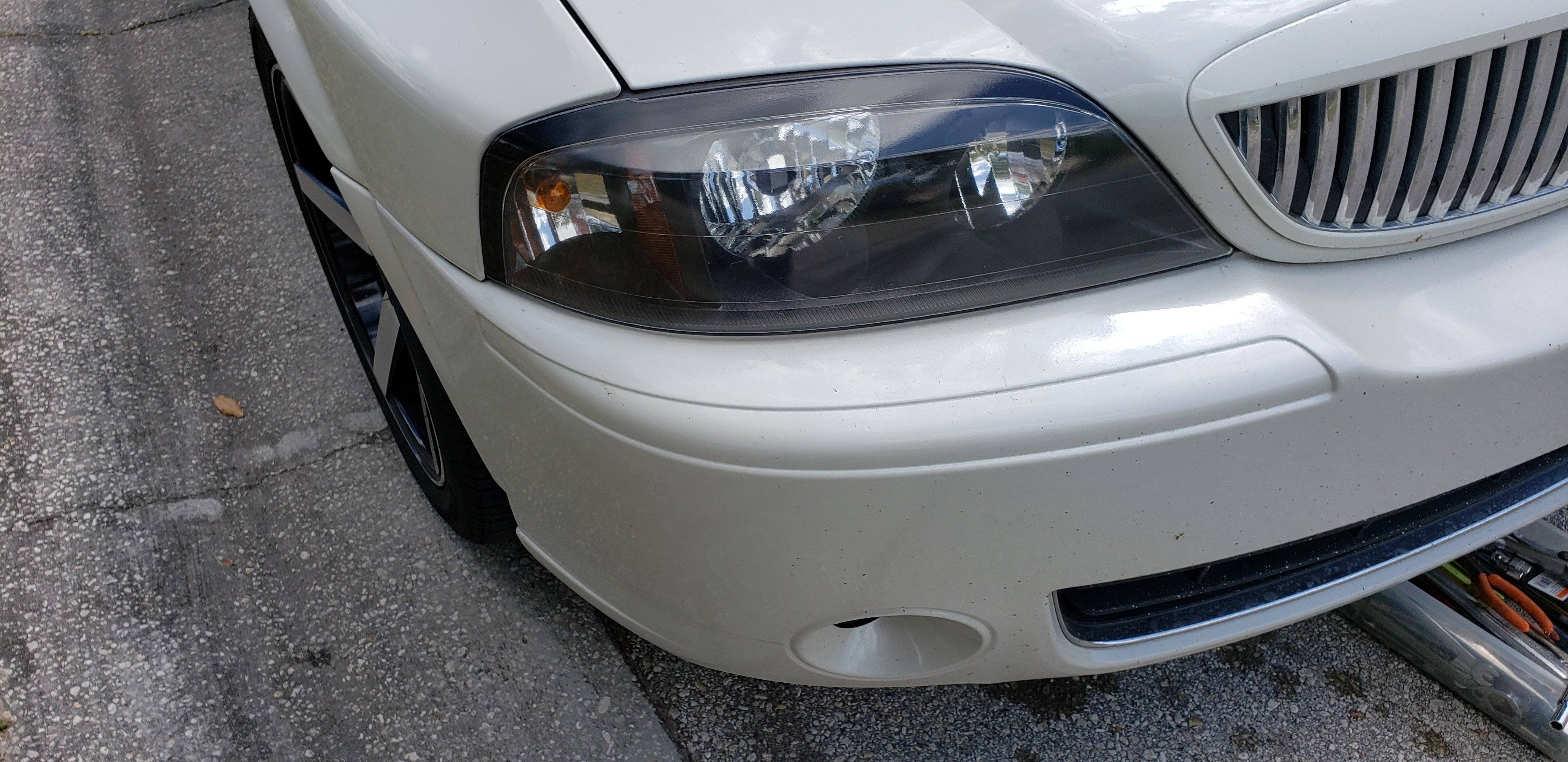

Just redid head lights today. 650grit 1000grit 3000grit wet sand rinse 1st layer of clearcoat 15 mins 2nd coat 15mins final heavy coat bake in sun for 45 mins at 85 degrees reinstall looks brand new.

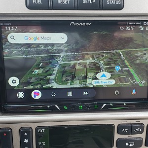

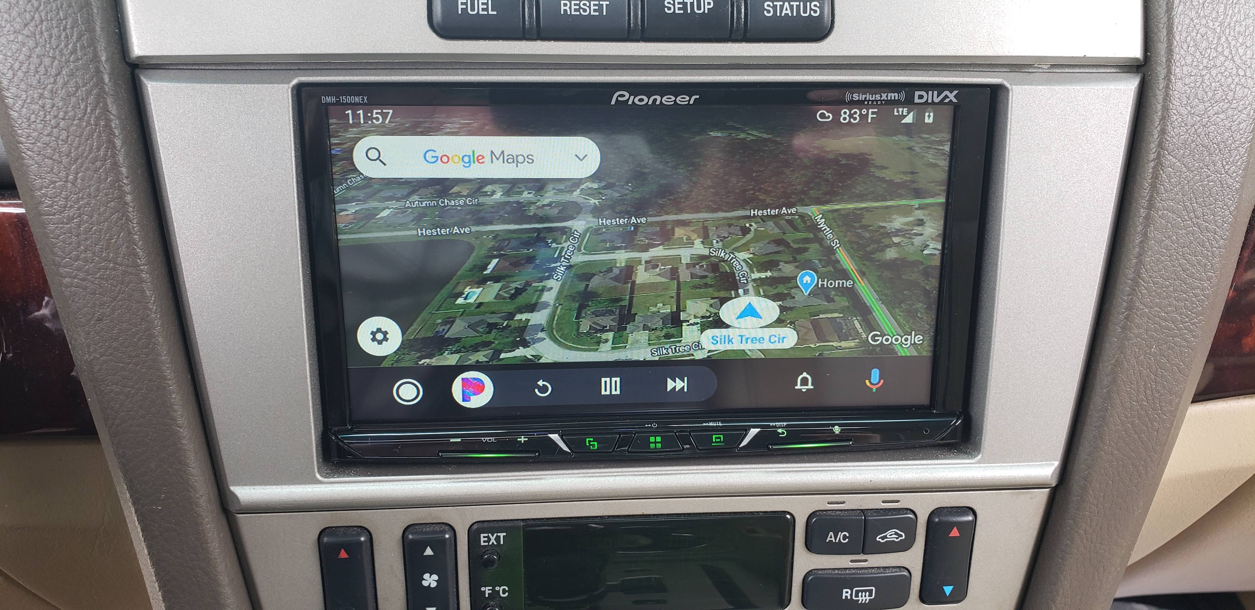

Just upgraded radio again wanted the android auto so I went with the dmh1500nex have to say the radio is clean and has all the goodies.
