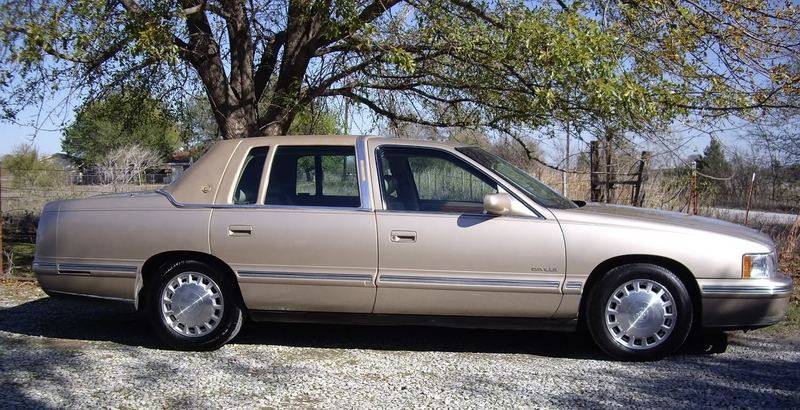

So the Vic is gone and on to the next. Dont laugh, its color is pimplicious. :lol:

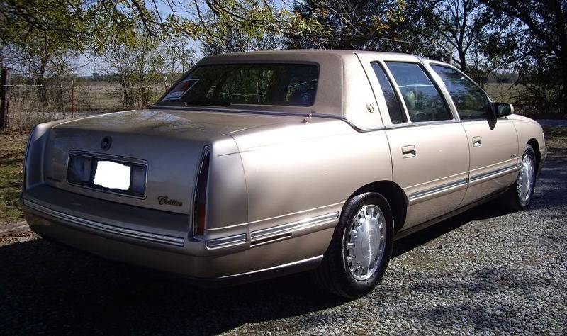

One owner 1997 Caddy Deville. Almost near perfect but has a couple scrapes on it. :(
Car does not have one single issue though. Lived in a heated garrage its whole life and it shows in the OEM paint and roof.

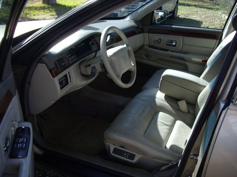

Not a bad looking car at all. It's funny that this car has the exact same steering column as my dad's old '79 El Camino:) It just makes me sad to see that engine mounted sideways:(
:lol: I made that EXACT same observation when driving Sapperfire back home. I said "Its kinda funny and kinda sad that GM has used the same column for over 30 years. They must have fired the MFC designer in the 70's and never bothered to make a new one." :lol:

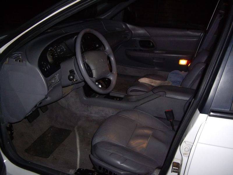

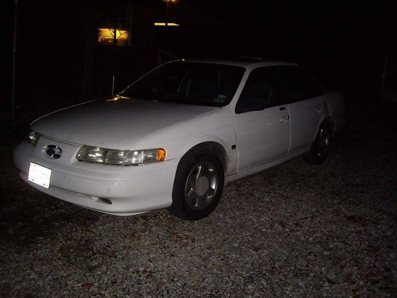

So the Caddy went fast. Went out and got something I really shouldnt have. A 1995 SHO ATX. Car ran great, had a few dings and a few issues but I REALLY wanted an SHO so I got it. Even bought it from a dealer cause I wanted to keep it for a while. Put 250 miles on it yesterday and it ran spectacular. Cleaned it up inside today and went to take it out for a wash and some pics and it stalled on me. Turned onto a street, had almost no power and stalled when I stopped in a driveway. Futzed with it for an hour and it started so I canceled my tow truck I was waiting on through Verizon Roadside. Continued on my trip and 9 miles latter it did the same thing. Have spark, have fuel at the rail so not sure what the issue is. I will test fuel pressure tomorrow and try to read the ECU. It starts for a second and stalls instantly so I am thinking low fuel pressure. Car had a spare Walbro pump and 6 SHO injectors in the trunk so..... meh.
Anyway here are a couple teasers from where the tow truck left it.

I shouldnt have an issue to make her run again. Was reading many threads talking about the CCRM as an issue and then VR4 even messaged me its prolly the CCRM. Steve is one of the smartest people I know and is a freakin savant with Fords so I feel better about that diagnosis.
If I didnt have to wait for UPS to drop off the Cobra calipers today I would take the Cobra to the JY and get a new CCRM. They have two auto SHOs so they should have two J code CCRMs. Since they are only $20 I was gonna get all they had and just craigslist the others since people get $60 for them on ebay. :lol:
Car hasnt been washed yet but I aint giving the bish a bath till she moves on her own again. Have power at the inertia switch so I guess the CCRM is working. Need Sapper to bring the fuel pressure test kit and scanner over so I can move to the next thing to check.
And yes, I realize the wheels are on backwards. :lol:

my brother's car has been through 2 FPRs. another thing to check. we haven't had good luck with them.
expensive SOBs too though.
what happened to the spoiler?
92 was the only gen2 not to have them. something happened to the trunk at one point.
you have no third brake light.
You will also notice it has a standard Taurus rear bumper. Its been smacked in the rear at some point and someone cheaped out on fixing it. It appears it was cosmetic cause removing the trunk carpet and looking under the car I cant find any dammage.

Just was able to test it and saw there is no fuel pressure. Cant hear the pump prime but there is voltage at the inertia switch and the CCRM is clicking. So must be fuel pump, just ordered a new one.
Went to the JY to get some goodies today for the SHO. Got another CCRM to just verify mine is OK and it is so now just have to wait on the fuel pump. There just happened to be a white 95 ATX SHO there so I got its trunk lock, window switches, floor mats, wing and rear bumper. :)
