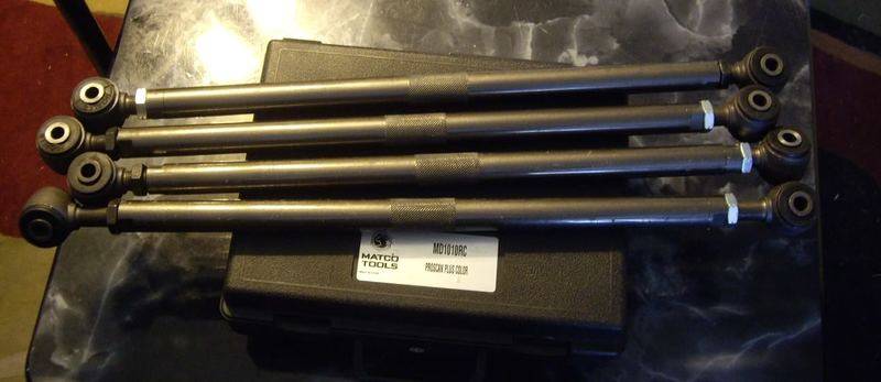

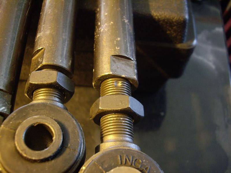

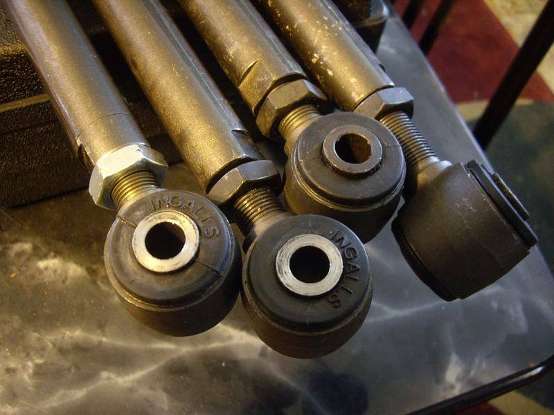

I love new aftermarket parts. The SHOs tubular LCAs showed up this morning. Guess I need to get it in the air and do some work. :)
Very nice construction and a VAST improvement over the crappy stamped steel LCAs in the car.

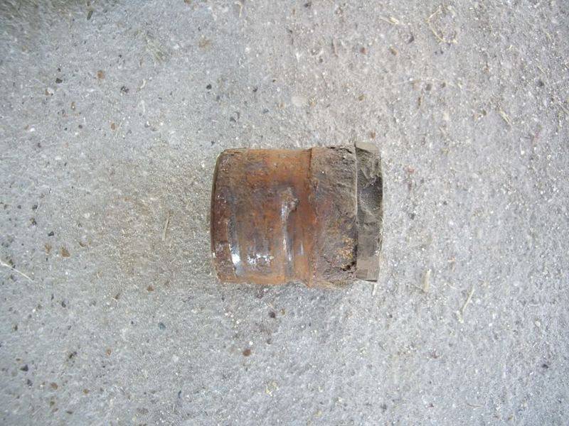

Damn LCA bushings are siezed to the spindle bolts. Gonna have to cut them off I guess.
Now I see why the ass would wiggle. The Bushing that controlls camber/castor is supposed to be attached to the LCA. After removing the bolt it just FELL out and rolled across the car port. :eek:

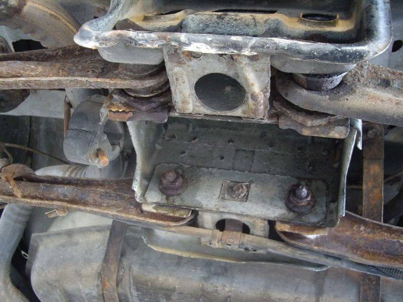

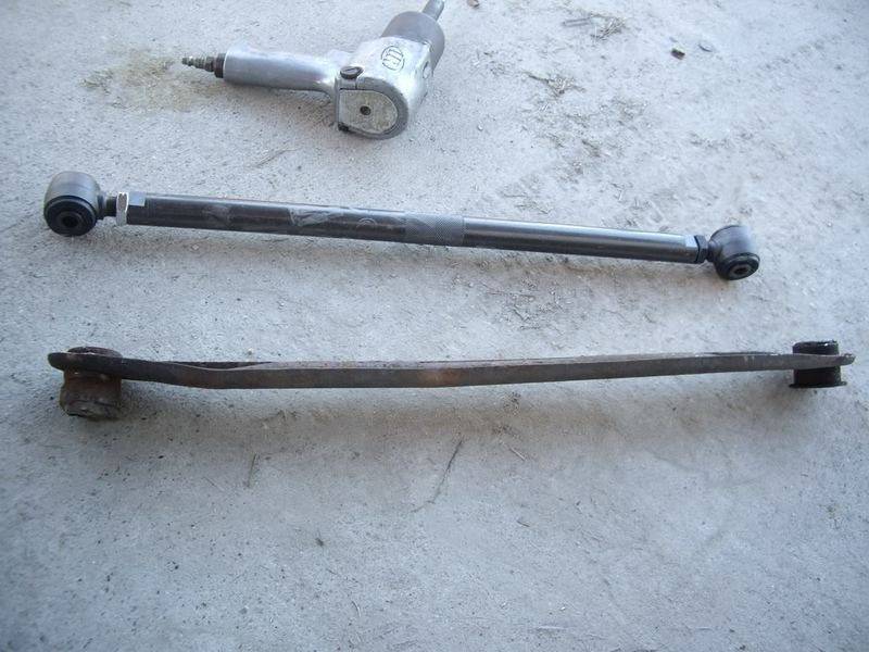

So here are some pics of the wonderful OEM arms in the car. That bushing is supposed to stay attached to the LCA. Can see its been worn down and out.

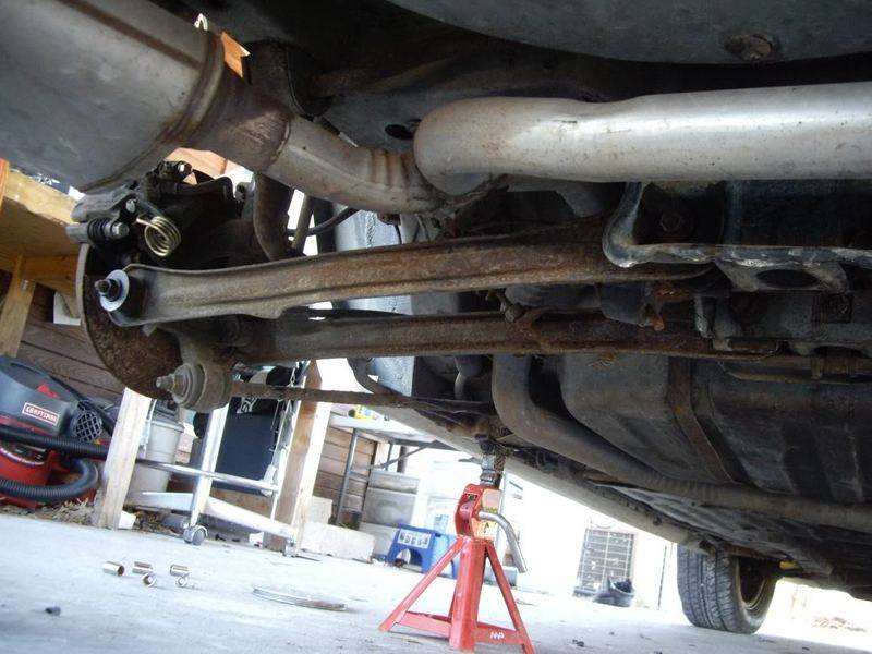

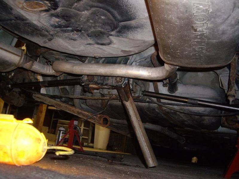

Fuggin SHO. Had to cut every single spindle to LCA bushing and sleeve off. Also there is one bolt that refuses to come out. Cant get a good angle on the head to cut it off. Been pounding the thing with a 5lb sledge and it just wont budge. Tried using my new C clamp and it just split in half (the C clamp). :eek:
So Sapper is gonna come back out tomorrow with a larger clamp to see if we can get that bolt to pop.
So this is where we gave up at. You will notice one arm is cut in half. Thats the one with the seized bolt. Its seized to the inner sleeve in the bushing.

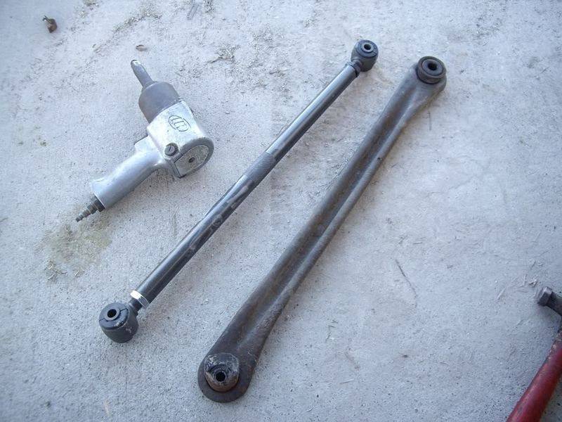

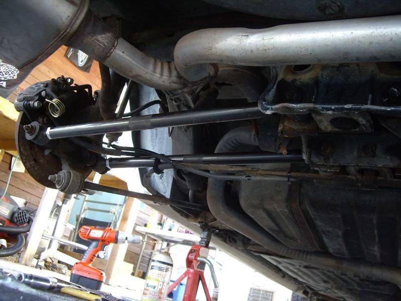

Got the passenger side done. The rear is much more solid now then it was with the factory crap. I used to be able to wiggle the rear hub front to back but now its freakin solid. Now just gotta figure out how to pop that last bolt free from its sleeve.

Gonna try. That pic angle is deceptive. The exhaust blocks the bolt head perfectly. Even with the exhaust out of the way the spare tire well blocks it too much to hit it straight on with a dremel cutter. Wore out one blade and broke another trying. Hell we burned through two reciprocating saw blades trying to cut the damn thing. :lol:
