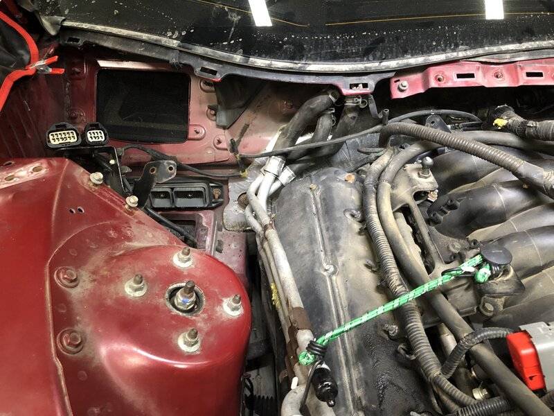

Here Is the firewall, where I managed to get the fitting off of the expansion valve and coaxed above the engine slightly.
I don't think I'll be able to get it out from the bottom. Any thoughts?

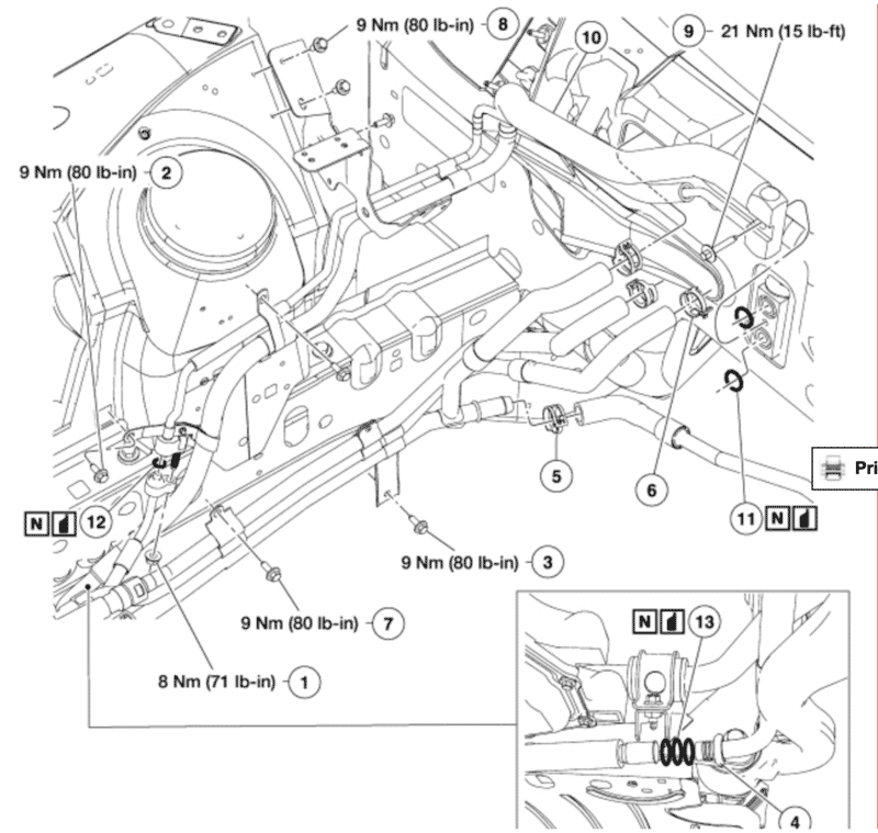

UPDATE: Finally got a little time to get back to this. Looked it up in the manual, and found that it is MUCH easier to get at by removing the wipers, wiper cowl, and HVAC pollen filter duct from the passenger side. Here is the shop manual illustration:
Now I'm going to try and fish it out without having to disconnect the heater core hoses at the firewall. I will update with the progress *if* I can get to it soon.
UPDATE again: what a PITA. I ended up having to disconnect the heater core hoses at the firewall, as well as disconnecting them from the DCCV up front. This allowed me enough access to slip the high/low pressure line assembly by the exhaust headers. However...it didn’t end there. You’ll also have to disconnect the battery and remove the two rightmost connectors from the PCM, as well as the bracket that holds wire looms to the passenger strut tower. There’s also a ground strap on the firewall that needs to be removed, and a couple of barbed retainers that hold wire looms to the top of the intake plenum.
As with most things, it’s doable but frustrating. Hopefully this helps someone at some point. Thanks again to those who have posted walkthroughs and help when they were in the middle of a project.
