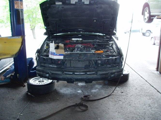

Removing that bumper cover is a lotta work for the air ride compressor. Hell, it's a lotta work just to change a grille. You can get to the compressor through the wheel well - just remove the plastic lining in there..that's how I swapped mine out, :Beer
To me, the 1st time I did it, I wanted to see exactly what I was doing. Removing the bumper cover didn't take long at all. Then I could see the whole assembly easily. Even now that I know what it takes to get it out, I'd still pull the cover. The grill is attached to the cover, I didn't seperate them. A phillips screw driver, 7/16 wrench, 5 push button thingies, If you got a stubbie phillips, you don't even have to take the wheel off.
I know all about having the front bumper cover off - we had it off to change my friend's busted grille. Still too much work - especially in the cold - for an air ride compressor. You can see perfectly fine through the wheel well.

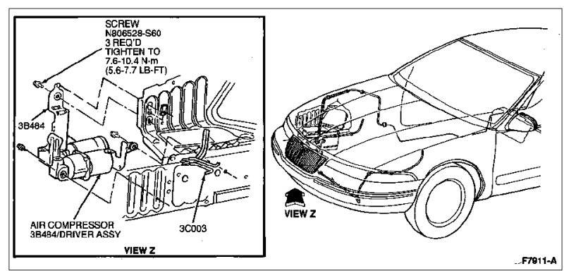

Hey my95mark8 - Here's the instructions from my AllData Cd:
Air Compressor and Drier Assembly
Removal
1. Remove the vehicle's front bumper cover as outlined in «Section 01-19».
NOTE:
The air compressor and drier assembly is located ahead of the front RH wheel. It may be convenient to service the solid state relay and the four air line connections by disassembling and carefully bending back the forward section of the RH front wheel splash shield.
2. Remove the fuel system carbon canister as outlined in «Section 03-13».
3. Disconnect the electrical connector for the compressor motor, located on the front face of the compressor bracket.
4. Disconnect the solid state relay connector, located on outboard face of the compressor bracket.
5. Disconnect the four air lines from the compressor drier as outlined.
6. Disconnect the wiring harness and front left air line clip from the rear face of the compressor bracket.
7. Remove the two lower screws that fasten the bracket to the body.
8. Remove the upper screw that fastens the top of the compressor bracket to the body.
9. Remove the assembly from the vehicle.
Maybe I'm reading it wrong, but it only says servicing the solid state relay and the four air line connections could be serviced this way, And it MAY BE convenient doesn't sound 100% confident to me. #1. Remove the vehicles front bumper cover. Thats what I see.

Hey removing the bumper is easy and takes very little time. Also it may take less time to remove the bumper than to wiggle your way around the wheel well.
