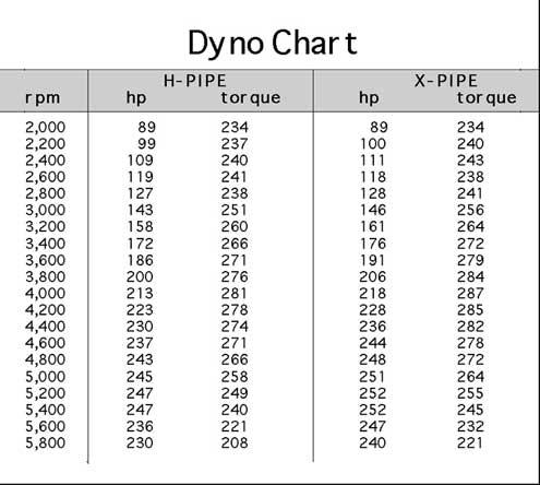

Here is a couple of things I found
http://www.lincolnvscadillac.com/attachment.php?attachmentid=38445&stc=1&d=1224869762[/iimg]
The “X” Crossover concept is the latest in exhaust technology. Our “X” Crossover setup will always be as good or better than the traditional H-pipe. In some street situations, you will not be able to tell the difference by the seat of the pants. We make the above statement not to "belittle" the benefits of the "X" Pipe Crossover technology, but to inform you that in a lot of street situations, you just won't feel any difference. With this in mind you might find spending the extra money worthwhile. It has a unique sound that many really like.
[url]http://www.mustang50magazine.com/techarticles/17880_1999_cobra_x_pipe/index.html[/url]
[ATTACH=full]38445[/ATTACH]

this is interesting, i'm contemplating doing my exhaust, since i have a 06 there isnt much gains from a new exhaust. i was considering getting the X-Pipe back and some mufflers
