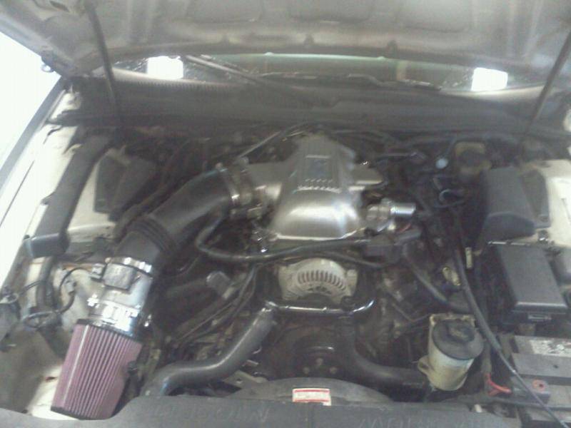

The intake manifold itself is going to make more of a difference. I suggest a 96-98 Cobra intake manifold at which point your CAI setup could consist of an 03-04 Cobra throttle body tube with a MAF adapter from Pep Boys for $20 and a K&N cone filter right behind the passenger side headlight. A shroud around the filter could make it closer to a true CAI setup keeping the heat from the engine bay down, but regardless you should see some better performance from the intake manifold than you will ever see from deleting the air box and making a CAI setup.
This is what you want:
If you can put a shroud around the filter, even better. If you can relocate the airride compressor and run the filter in the fenderwell, that would be even better yet other than a custom ram air setup like "Right on the Mark" has which I think is basically a CAI setup with some sort of forced air entry.
