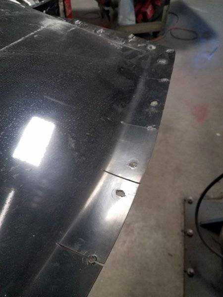

So I'm doing a cowl on my hood. I'm just curious how anyone that has experience manipulates the fiberglass to conform to the hood. This is what I have done so far but the lip of the fiberglass cowl still has a nice bump in it. I've been gently using a heat gun to try to help as well as cutting reliefs in sections to also aid but I'm kinda stuck. Any suggestions??

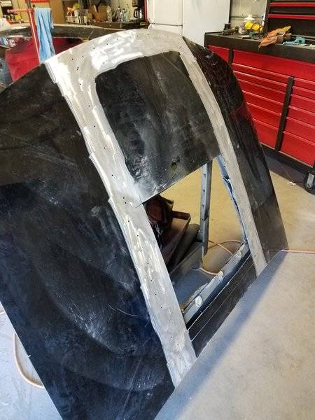

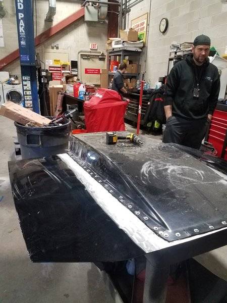

Lil update now that I had time. Left the cowl bolted to the hood to kinda use the shop heat to conform... didn't do too much lol stiff as a båstard... set the epoxy to hold it. Well see how it holds then onto filler when the bolts come out!

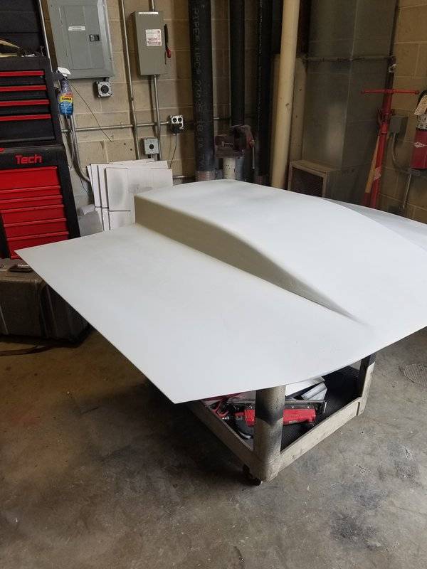

Haven't gotten a chance to upload or really work on this... frigged my arm up so I've been behind. But here's the hood in first primer. Need a lil more bondo and some sanding then paint..

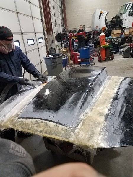

Not how I would do it but you are getting there. Now I worked for years in fiberglass, so it's not surprising.
I would turn the hood into a mold then add the scoop. Then you can pop out new ones, as needed.

Haha well bless ur heart. I'll stick to building cars not body work what a pita... I'd never do another one, so no mold needed
