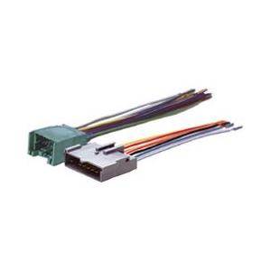

I sure hope you're using a plug and play harness.
Just get a plug and play harness and simplify everything. When you get the factory stereo brought to you, shipped to you, then remove the harness and plug in the factory unit. I would jerk it all out personally and put all aftermarket in. You will have this problem again but it might be the amp next.
