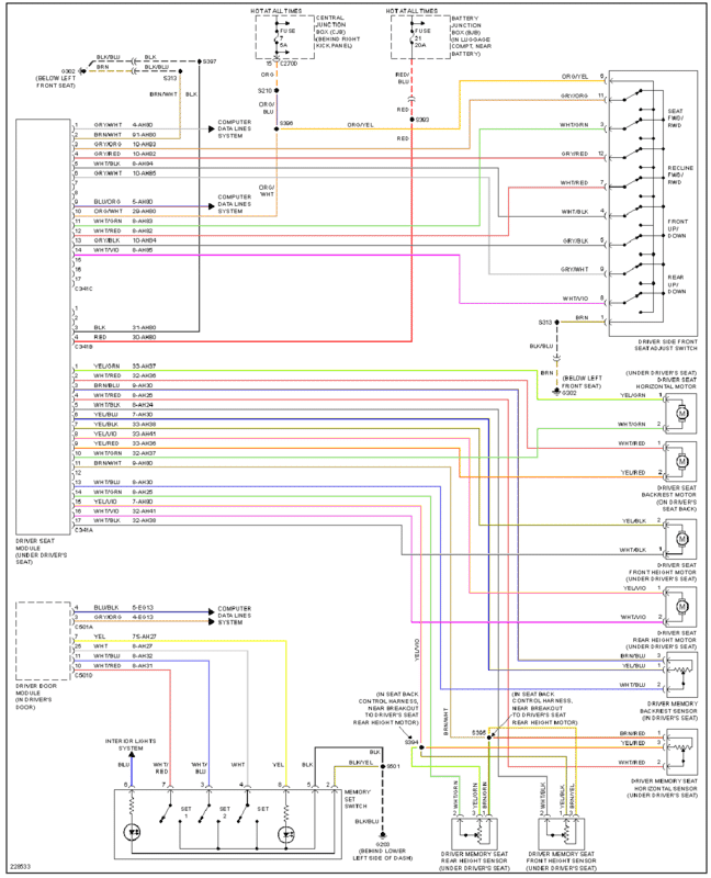

I have the diagrams, but I don't think they will help you much. The driver's seat has an electronic module that reads the seat switches and drives the motors. I'm not sure you can use that module and keep it happy without it communicating with other LS modules. You can bypass the module and wire the motors directly to the switches, but I don't know if the driver side ones can handle the motor currents or not.
The passenger side seat is simpler. Maybe you could move the controls from the passenger side to the driver's side. For the airbag, just permanently short the two wires from the airbag together. Even better would be to remove it.
I am assuming here that you are not trying to retain the heated/cooled feature. AFAIK, that's not going to work without the DATC.

If I get a chance, I'll post the diagrams tonight.
You need at least the DSM (Driver's Seat Module), and the DDM (Driver's Door Module) may be needed.
I can get them both. The yard is about 2 hrs away. Is there anything you need out of a lincoln. They have quite a few lincolns. Its a pick n pull. Parts are cheap.
Welll I got it all done. I hope this helps somebody. I went back to the j.yard and bought another passenger seat (just the bottom frame and wire harness). Then installed the harness on the d.seat. Was simple and easy. I know have 2 full function electric seats in my Volvo 240. I will say I love the LS and I am looking for one to purchase.
