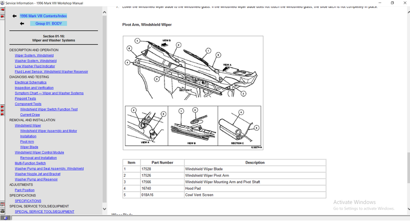

Looks like some "nice" person placed two small stones next to the pivot and now my wipers will on go about one inch and then return down. I believe the arm and pivot assembly has been damaged as the motor runs ok.
My friend at the Lincoln dealer told me the 94-96 unit is what I need.
Hopefully someone in the group can point me in the right direction!
Joe O

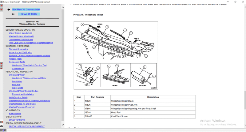

Try this part number I got from the workshop manual. 6C3Z-17566-A
https://www.amazon.com/Ford-6C3Z-17566-ARM-PIVOT-SHAFT/dp/B001H293XU
6C3Z-17566-A - Genuine Ford Parts
I've uploaded the Wiper Assembly PDF, the information you want should be on pages 5-7.
Good luck!
