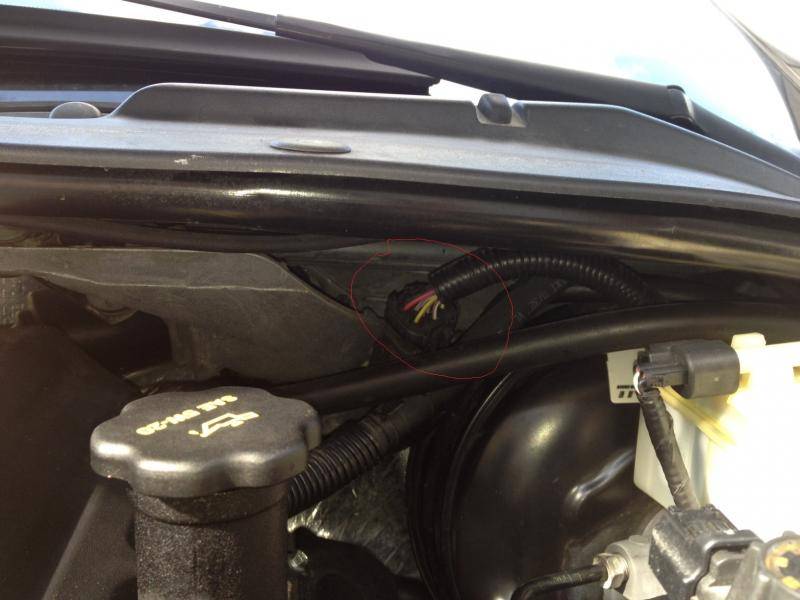

Joe, I had just found a post of yours from 2013 when I searched for 'wiper motor assembly.' This photo was in your thread. I went and found that and moved it slightly around a bit, could have sworn I heard a little noise. Then I had someone try to turn the washer on as I moved that connection around again and it worked! You are the man Joe. Thanks again! Do you think it's ok now, or probably going to flair up again and what exactly would you think would need to be done/replaced at that point?

I recall moving it a bit a few times to get it to work for a while. Finally (months or years), it stopped and wiggling no longer brought it back. That's when I took the motor apart. It's been good since then.

So the part that this harness plugs into is the wiper motor? If it fails to work again at some point, then would the harness or the wiper motor most likely be the problem? I guess that would depend on what is or isn't actually happening at that point. If the same issue of no fluid, then which would you think?

I was pretty sure it would be the harness, but I couldn't find any problem with it in my case. May have been the soldering of the connector to the electronics board in the wiper motor.

Since the connector wires are about 1/2 inch from the degas tank, maybe when all of the coolant parts were getting replaced something accidentally happened to it then. Hopefully it will be ok now. *fingers crossed* Thanks again Joe.
