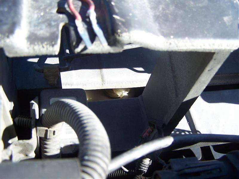

I finaly got around to pulling the old one from my parts mark and found that it has had the same issue and the plug has been jumped.
Heres the pics
In the top pic you can see the sensor (barely) and the plug just below and to the right. Also at the top of the pic, a bit blurry is the jumper wire I found in my sensor plug. I had been plugged in and covered with electrical tape.
So I might not have got the sensor I needed but now I dont have to make a jumper :)
