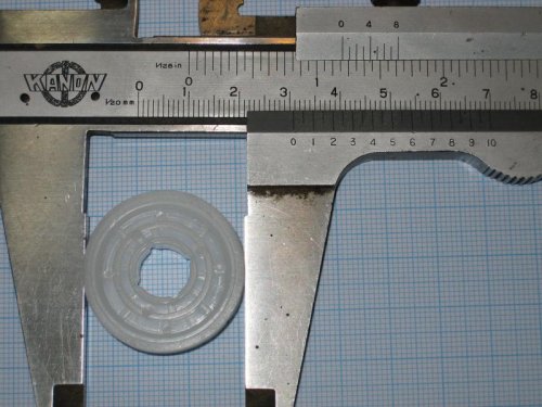

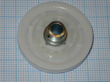

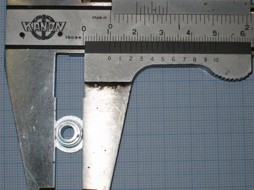

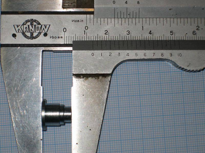

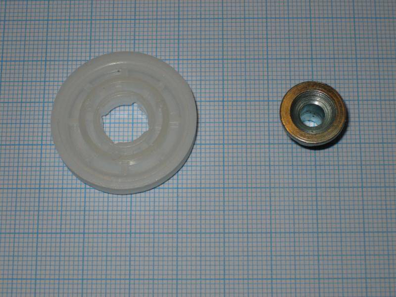

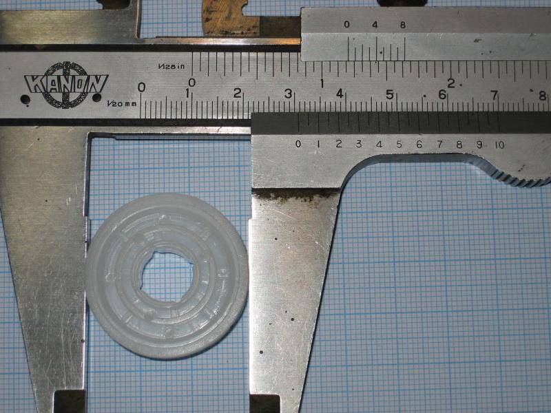

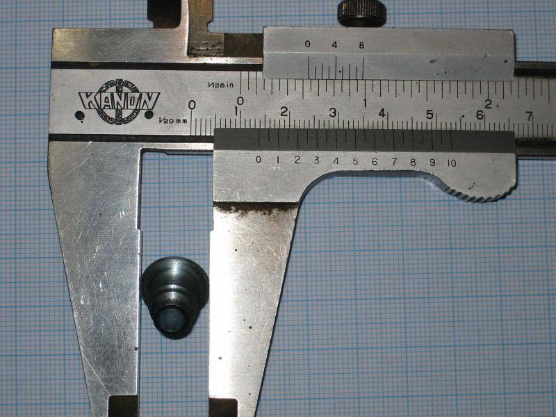

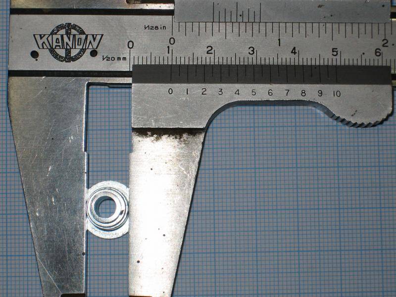

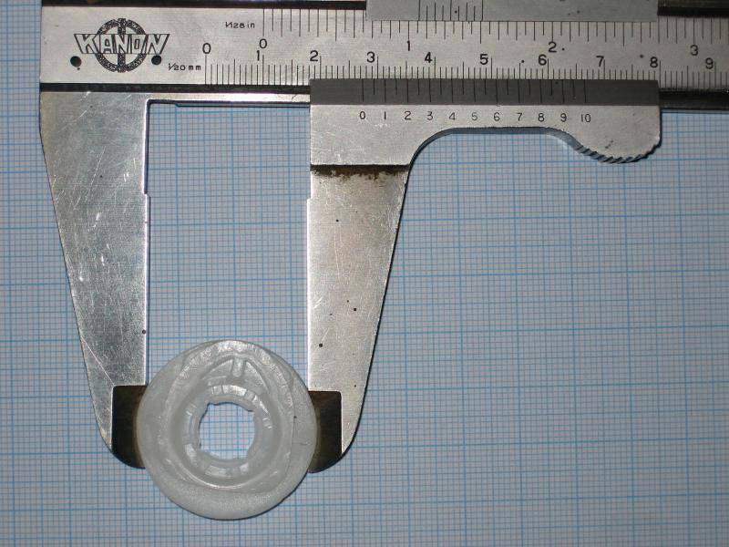

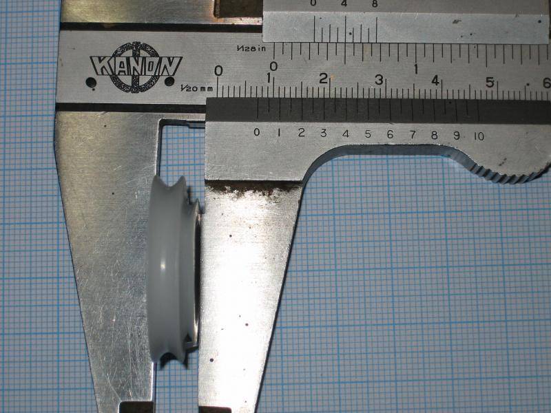

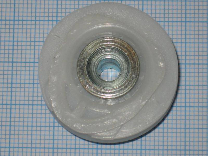

The folks at RegulatorFix (from whom I bought the replacement clip) also sell a replacement guide pulley, though it is not specific to the LS. Here are the photos they sent me:
I'm going to take a caliper to mine tonight to measure. If it looks like it will work, I'll probably give this a shot.
that's nice to know that someone sells the pulley itself. regulatorfix?
Yep, that's RegulatorFix. Unfortunately, this pulley they sell is not the same size as the pulley on the rear regulators on the LS. The photos above indicate that the RegulatorFix pulley has an outer diameter of 1.203". I measured my guide pulley and the stock pulley on the Lincoln LS rear regulators has an outer diameter of 1.678". So the RegulatorFix pulley is almost 30% smaller than stock.
It might be possible to use a smaller pulley in this application if you drill a new hole in the metal and move the pulley mounting point further away to compensate for the smaller size and ensure that the cable is properly tensioned, but under the circumstances, I decided to just go ahead and buy the Dorman regulator.
