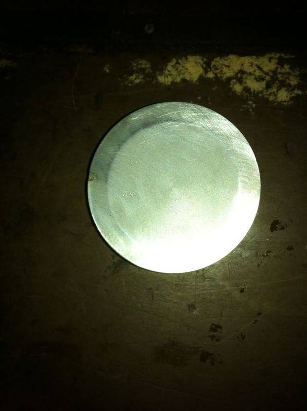

Will these piston rings work?
I would assume, unless Ford made a change to the thickness of the ring grooves in the pistons in 98...
I would not use as this is a very critical part of your engine and to try and save $60 on something this important isn't worth it in my book. What is ring material?? etc

Forget buying new pistons. The original pistons are more than adequate for your rebuild. Just get new rings from Max or your local Ford Dealer you'll be good to go. Unless your plans is for some big motor build, but I suspect not if you are looking at those pistons. When I took my block to the machine shop, my pistons were still good. I still have mine.
