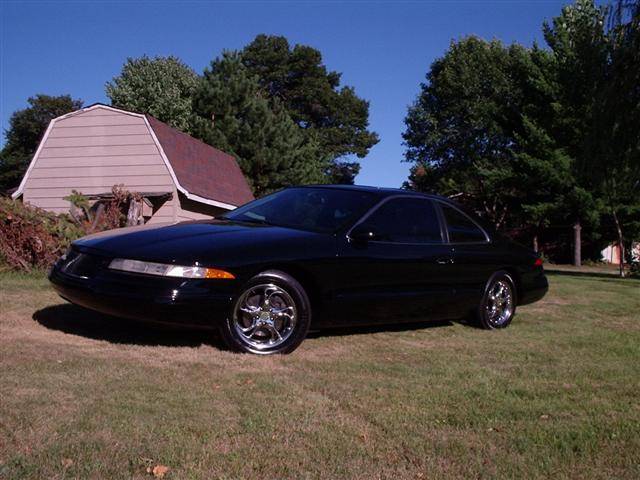

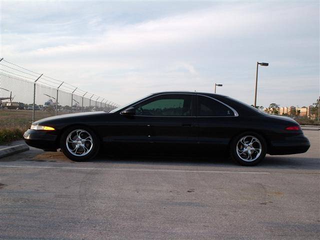

look ma no chrome, HA HA! just paint it man easy thing to do , just remember its all in the prep

wow, that looks awesome....i bought an 86 Monte Carlo LS, that i was planing on cloning into an SS...the problem is, the chrome trim. Im assuming its the same with the mark. If you take the trim off, you have to remove the windows and then get the regular LSC trim, and put that on and put some sealant on it, and put the windows back in. I could very well be wrong with the mark. All i know is, it would be a pain to do with the MC, and i wouldnt want to try with the mark even though i think it looks awesome.
That's what I thought. Speaking of chrome, did you paint the chrome around your windows or did you use an overlay of some sort?
Just masked off the windows and chrome.
Its a bad paint job on mine though, its going back to the paint booth on Monday, to have them redo it cuz its chipping off and it was not evenly sprayed and spots weren't painted and there is defects, so I talked them in to redoing it for free, other wise I wouldn't go back to them. I think the problem is it was too humid or the wrong kind of paint was used. If you look at the car domain site you will see how all the paint is chipping from my bumper and chrome lip.
