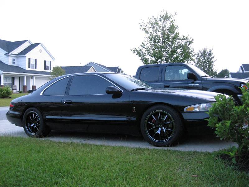

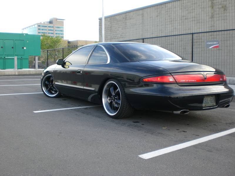

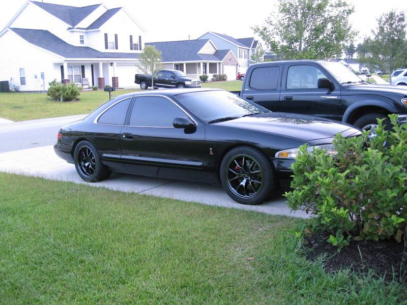

Posting these for TOLIncoln
Mine are 18x10's, and are +40mm offset. With my 285's, I did have to roll the fenders, but with a 45mm offset and 275's, you'll have a little bit more room to work with...
that looks so killer, i love it. Eventually i'd like to get a set of 20's for cruising...they look so killer, but the 18's will have to do for now while its a daily driver that i take to the track.
