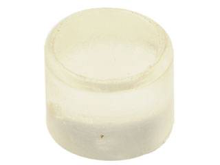

One thing I do know is that I had 3 windows fail within a week of each other. I took me 4 hours in the driveway on a 90° day to change out the clutch drive dogs in all 4 windows. The fourth one was within hours of failing as well. The dogs turn to mush and crumble over time, ergo no coupling between the motor and regulator. The drive dogs can be found at any good parts store that carries the Dorman 'Help' line and have the P/N 74410. They were $7.99/card/window a little over a year ago. Replacement requires drilling out the original rivets and replacing them with 1/4” X 1/2” bolts and nylock nuts when reassembling.
The drive dogs:

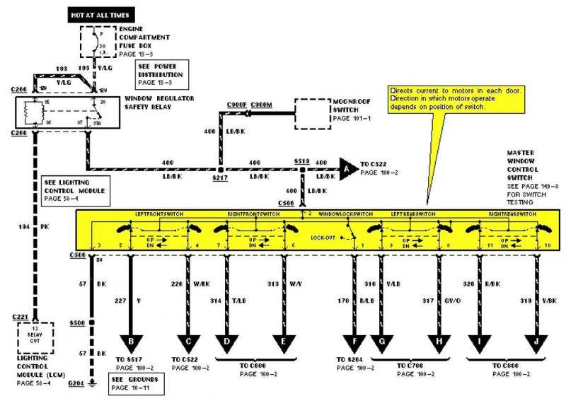

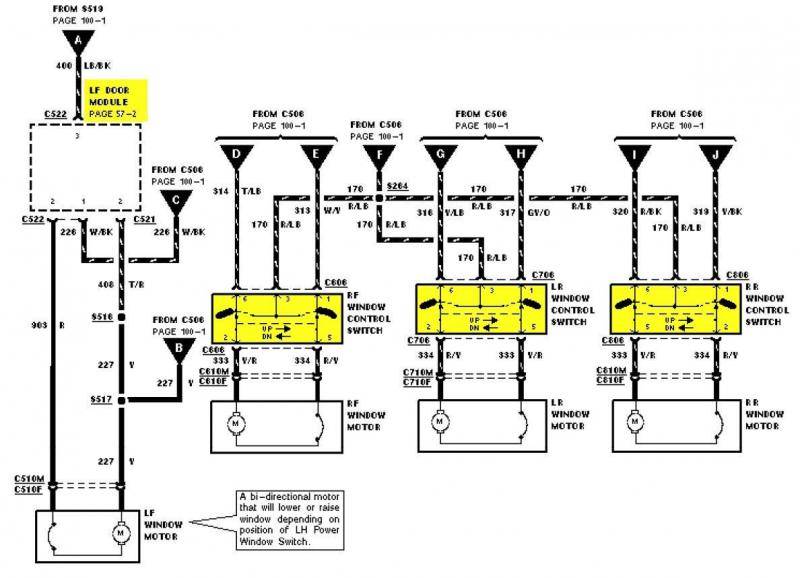

Yes the '97 models came with the 'one touch down window’ feature. That is controlled by the left front door module. I think you can surmise where that module is located. If that feature has gone awry, there are firms that sell the OTDW control modules with harness. I added one to my '92 and it works as advertised. The same module that was used by FoMoCo in earlier models.
If you desire wiring road maps I can furnish those as well.
