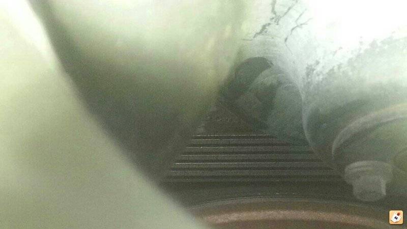

Belt looks alil cracked dont kno if its just normal after use.
Technically, it's okay for them to be cracked, as long as chunks of the ribs aren't missing. However, Even at over 100K miles my belts that I have replaced have looked much better than that (no visible cracks). I would replace the belt. Make sure you don't have coolant leaking on to it anywhere.

Heres another vid showing a little bit more. Hard showing the belt from the top.

Looks like the tensioner and the damper are okay. Do try the test with the belt off, assuming that it normally makes the same noise when cold. If there is a next time, please turn your phone sideways when making a video...
