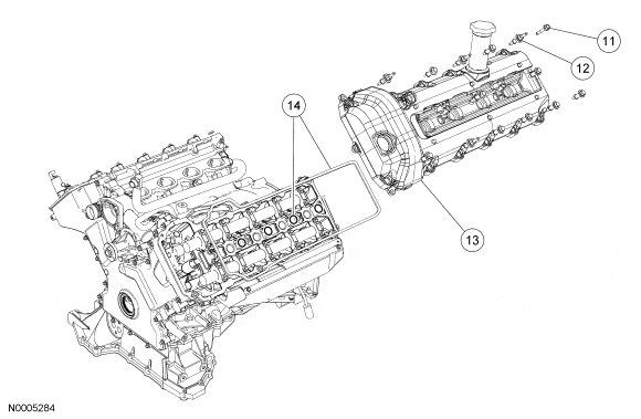

We people call the Valve cover gaskets what they are,
the gaskets that seal down the Valve covers.
#13 = Valve cover
#14 = Valve cover gaskets & Plug well O-rings

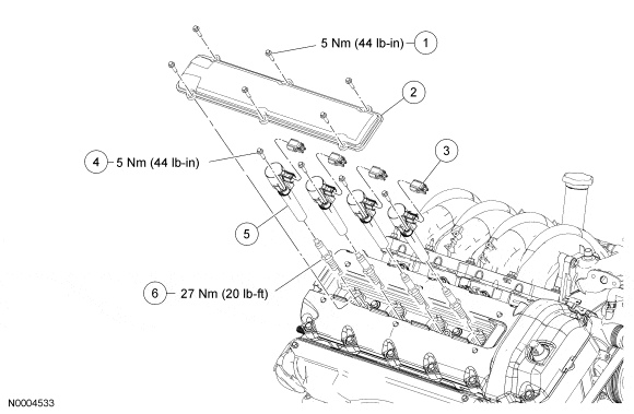

We people call the Ignition Coil-on-Plug covers what they are,
the cover that has it's own embedded gasket that seals down the Coil cover to the Valve cover.
#2 = Ignition coil cover
Arrow points to the gasket on the inside of a Coil cover.
