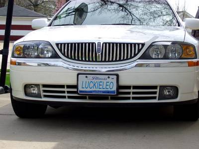

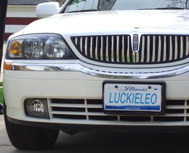

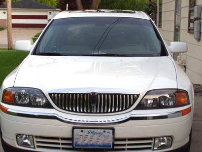

k... heres some pics in the dark... they do not do justice whatsoever.. i'll have to take better ones tomorrow...
they look really sharp!! :L
before & after & a close up of the rounded look foglights...

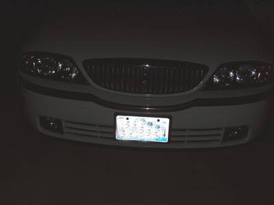

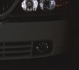

yeah, i tried taking one of the lights on, but its all blurry and you cant tell...
i dont have a before & after of the lights on in the dark. i'll def take some pics tomorrow. take my word for it, its a good upgrade & you wont be dissapointed! :wrench
heres a pic with the lights on in the dark... you can tell the foglights are different, but with the orange bulb on, you cant tell i have clear corners.. you can in the light & it looks so much nicer!!! but today was a good day for my LS. i think it looks great! definitely go for the new fogs. its a $70 way to upgrade the look of the car. i'm glad i bought em. my hands still hurt & my nails look like $hlt now, but hey, the LS looks good! :L

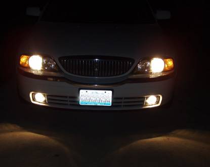

Please excuse all the dead bugs, that was after about 200 miles of 100mph driving - they couldn't get out of the way fast enough :D.
That's a 2000 w/ 03 fogs and grille. I didn't have too much trouble installing them with just basic tools, but I don't think they're held in there all that well, with only 1 solid peg, and one 1/2 attached peg. But after all the abusive driving I've done they're still on there. Which is all that matters.
