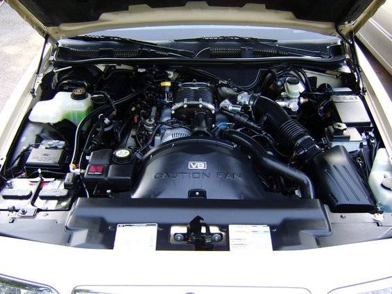

I don't have a Town Car, though I do have a '96 Grand Marquis which is mostly the same (with the powertrain being identical)
I recently completed a supercharger installation on that car:
If you're going to modify, a '96-'97 is strongly recommended over the 91-95s.
Ok bro, more info on the SUPERCHARGER!!!! how you did it, what kind of setup did you use, and how much did it cost you? You should actually start your own thread for this:) I want details, like all of them. I have been looking at the Allen supercharger sets for these, but you obviously went a different direction with yours.
nevermind, I just went on your website and on the others and got the info on the setup. Very nicely done. Can't wait to hear what kind of power she is putting out to the wheels and what kind of time you can get it on the track.
Nice work dRock but it is not a TC. You are the bar that I am shooting for on my TC though.
