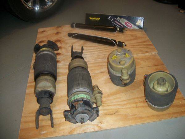

I only have a pic of the Gen II's

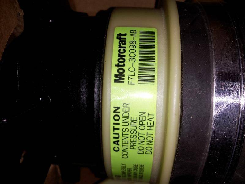

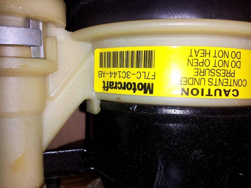

Well I bought new motorcraft units and they were made near the end of 2011. Note that the numbers for the original shock and new units are the same except the last letters. The originals ended with a AA while these end with a AB. Now my base and lsc both end with AA and have the same numbers. The solenoid area(the top ring where the sticker is) of my lsc however is painted black, maybe the old owner? This all doesn't make sense at all since there are no clear answers. I'll have to see how these new units compare to my lsc. I may pull the shock cover off the lsc to see if it has original shocks. Maybe someone modified it? Also, all this valve timing would have to be from the spring itself right? Nothing computer/compressor driven? This again doesn't make sense since both shocks have the same part number on my lsc and base.
