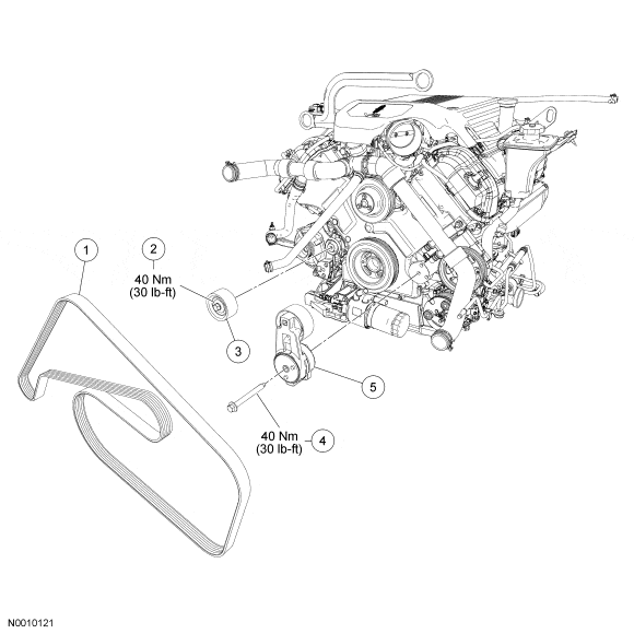

Might be something running of the accessory drive system, tensioner pulley, a bearing on one of the idler pulleys, water pump, hydraulic pump, alternator etc. I just changed a bunch of parts and belt this past weekend on my 01 and it runs real nice and quiet now, I could feel it in two of the bearings that they were done.
