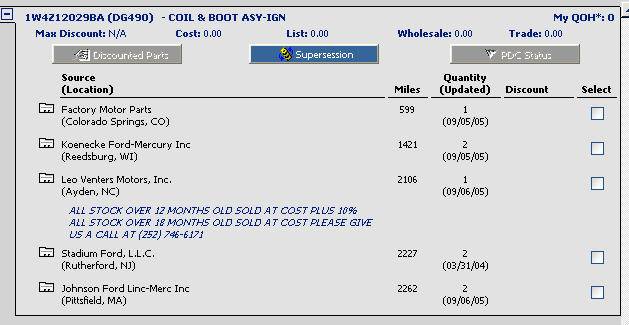

2W4Z-12029-BC (DG-209) has been replaced by 2W4Z-12029-BD (DG-515).
List $100.00 Regular Inet $75.00 LvC $60.00 each, plus free S&H.
BTW, good luck trying to find those old part #'s. Below is a list of dealers that have thr original part # in stock. These are the last of the last.
