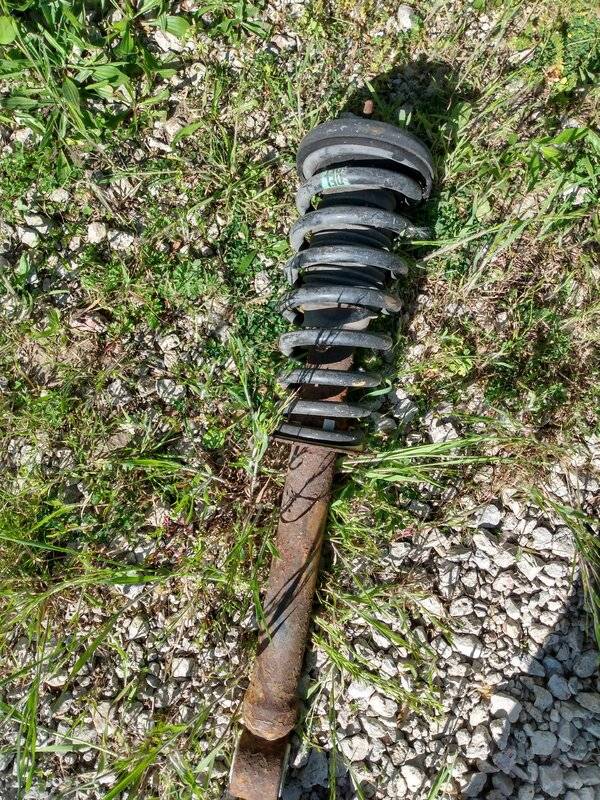

Look at this spring/shock assembly.
It has a green tag at the top of the spring. Green tag springs are for the Sport V8. You will find green tags on all 4 sport springs.
Other color codes are yellow, or orange, or blue... depending on the options on the LS you have.
